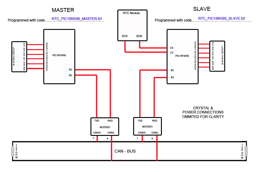

Sorry Enamul, I have got really confused with all this chip swapping, I need the circuit for the chip that I have just programmed with the pickit 3 as I am putting it together on a breadboard and the fcf file only shows an LCD...
thanks
Acestu

Re: RTC for Miac(Part One)
This circuit..but LCD in PORTD for both master and slave..not in PORTC
Thanks,
In the diagram Enamul, 1x unit is called DISPLAY and the other is called COLLECTETOR, what does collector mean ?
Is the display a slave, and the collector a Master ?
Also am I right in thinking that the Master will eventually be the miac unit and the slave has the set date time program on it ?
thanks
Acestu
thanks
Acestu
Display is slave..Collector is Master..RTC time & Date collector.In the diagram Enamul, 1x unit is called DISPLAY and the other is called COLLECTETOR, what does collector mean ?
Yes..you are right.Also am I right in thinking that the Master will eventually be the miac unit and the slave has the set date time program on it ?

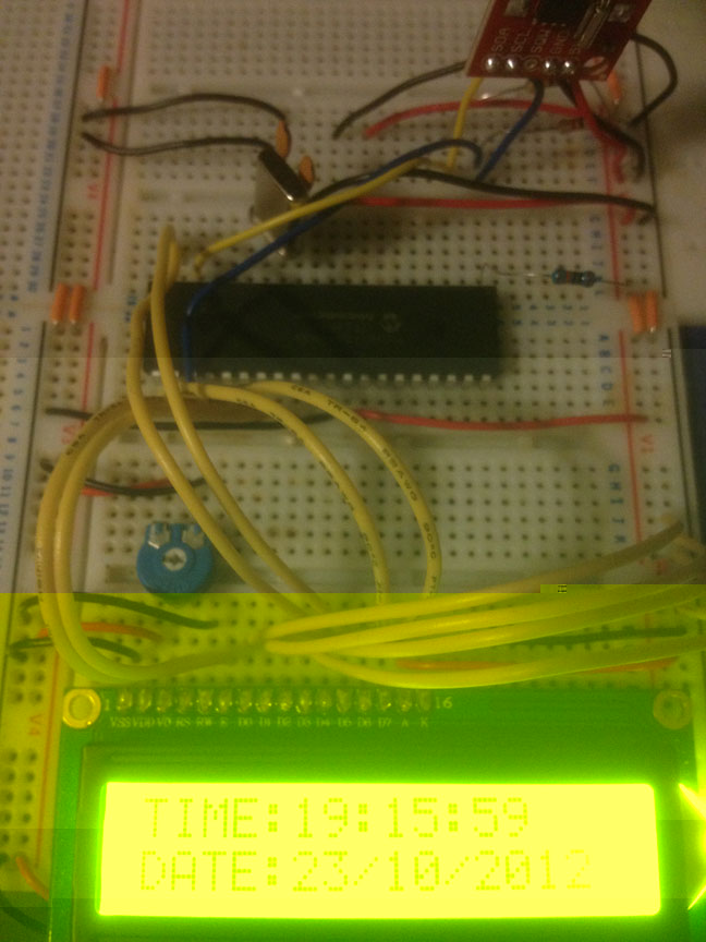

Hi Enamul,
I am sending a picture of the rtc board, I have just plugged it in and the time and date are correct
Acestu
Ok..nice to see that..I think understand that this board will now have CAN IC MCP2551 as well in RB2 and RB3 to connect with Master..I will post shortly the program to transfer this data to Master.

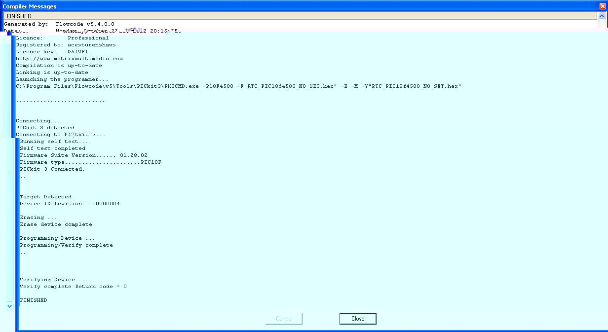

Hi Enamul,
I have just got my new chips Pic18f4580, I? have loaded the program RTC_PIC184580_NO_SET and I have just put it in the Dev board and clicked on Build/Compile To Chip, now after a few dots appear on the screen the chip configuration window opens but the settings do not look right, ie Watchdog Timer is enabled etc, and I am not sure what all the settings should be, is this right ?
thanks
Acestu
Ok Enamul , touch wood I think I have sorted it, I now have a programmed chip with the RTC_PIC18F4580_NO_SET code on it.
thanks

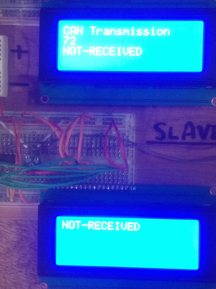

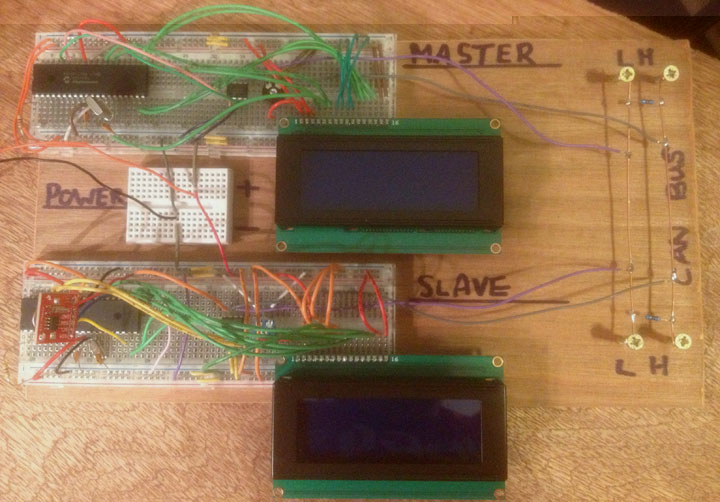

Hi Enamul,
Back on track now I think after all the trouble I have had with duff chips etc.
Anyway I now have two 20 x 4 LCD modules and I am posting a diagram of the circuit which is what I am going to build next.
Acestu

Hi Stuart,
Exactly this what I want from you to make in the circuit and put appropriate program. You should see clock running in both display. Later on we will replace Master by MIAC. You are close now. We can open another thread(part two) when this part will finish.
MIAC testing we will do in new thread.

Hi Enamul,
I have set up the circuit as per diagram but I don't get the date on any of the lcd displays, it just shows what is in the pic I have posted.
thanks
Acestu
Do the unused pins on the MCP2551 need to be earthed ?
thanks
Acestu

Ok sorry,
I have had to reprogram the chips they had the old code in them,
Now the Master LCD says "Master RTC Unit" but the Slave LCD says nothing
P.S. Do I have to set the first time before i program the chip in order to get something on the LCD screen ?
thanks
Acestu
thanks
Acestu

Hi Enamul,
I have a spare pic18f4580 chip so I have programmed it with the slave code and set it up on a breadboard but this too does not show anything on the LCD unit
Do you have any ideas please
thanks
Acestu
thanks
Acestu
