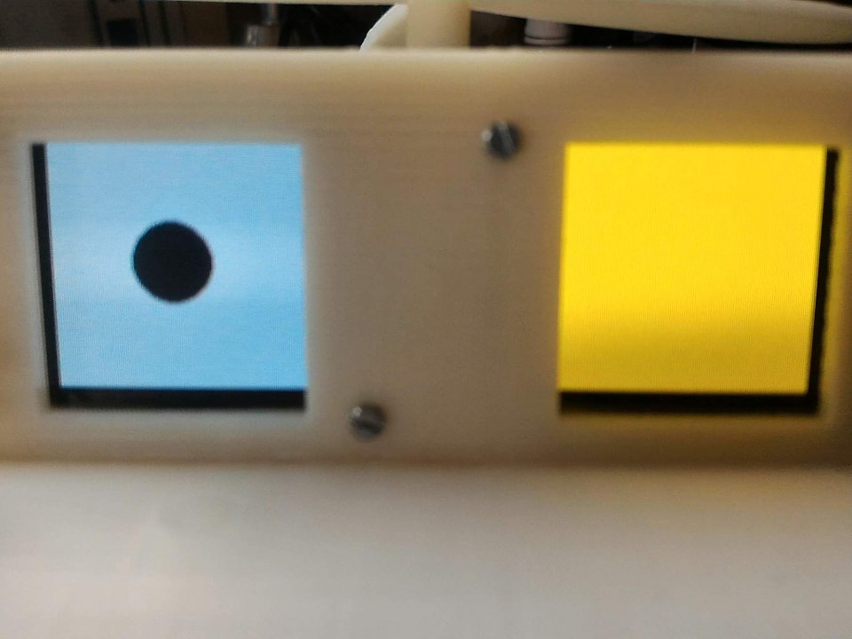

The setting of the left display is OK with flowcode1.fcfx but not with the flowcode2.fcfx file: the reset command works but the program remains locked in the "initialize" function as explained above ...
not OK.jpg (63.59 KiB) Viewed 45503 times

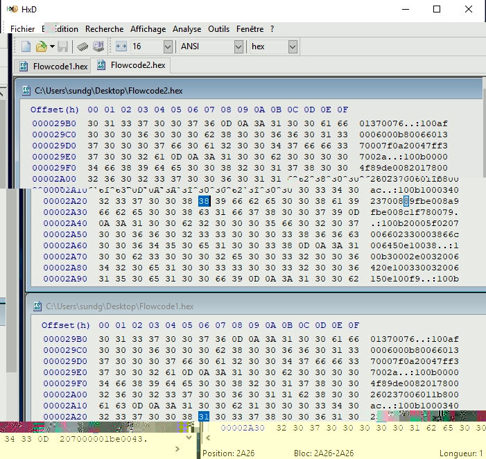

In the zip files of the two examples "flowcode1 and flowcode2 above, the hex files are not the same:
During my last sessions with my students, they all had more or less the concern: sometimes it worked and, during a change of computer station, it does not work anymore!
All my posts have been updated with the latest versions of flowcode as well as the file "FC7_Latest_Files_16-05-18.zip".
There is a problem with the component macro GLCD; the settings are not taken into account correctly.
