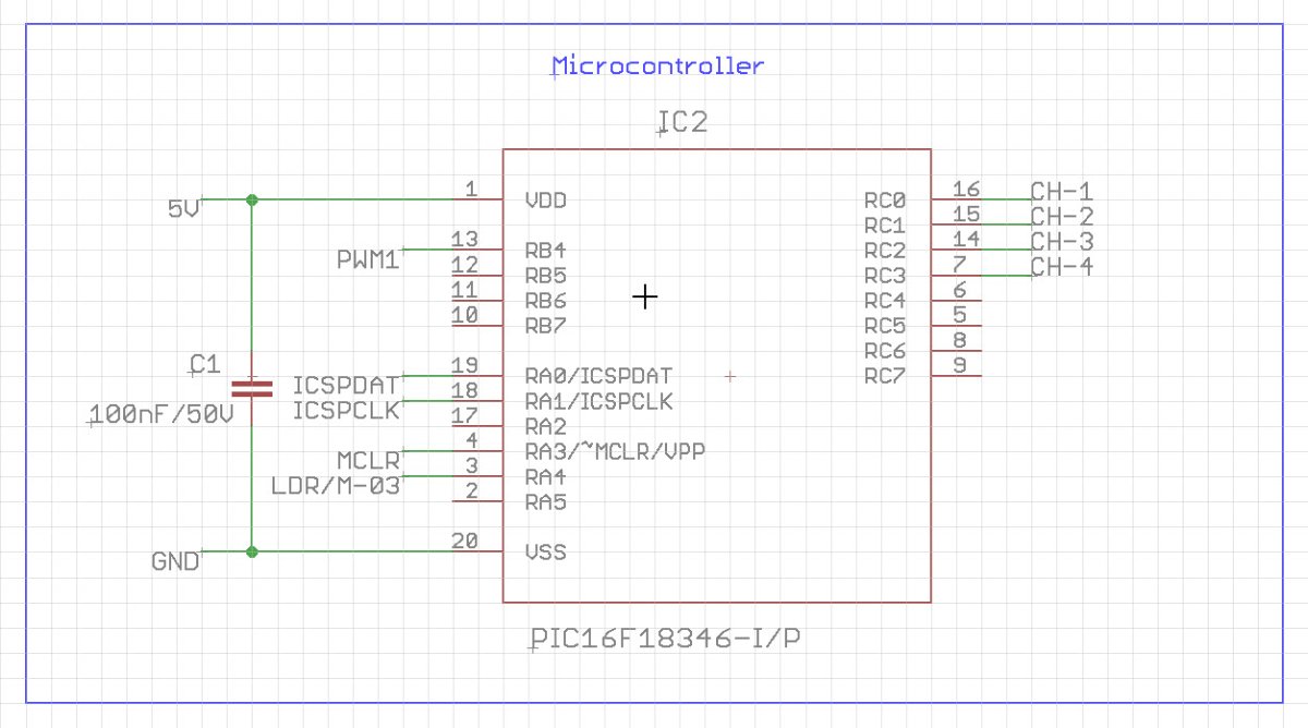

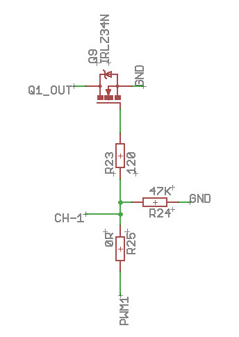

Re: LDR (Light Dependent Resistor
Hi Martin,
Thanks, I will wait for it.
I have made it on a breadboard based on your “LDR Bright Control1.png”. I have used logic level NPN mosfets.
This example shows 1 mosfet. When adding mosfet 3 it looks like the PWM1 pin can’t handle it anymore and PWM1 stops working.(The 0R resistor is just in the schematic to separate nets)
In this flowchart I’m just testing the PWM part. The nicest thing is that I can give a certain Brightness level and not goes lower than that I also tried it with a TC4427 (mosfet driver) in the PWM1 line but no luck.
Frank
Frank

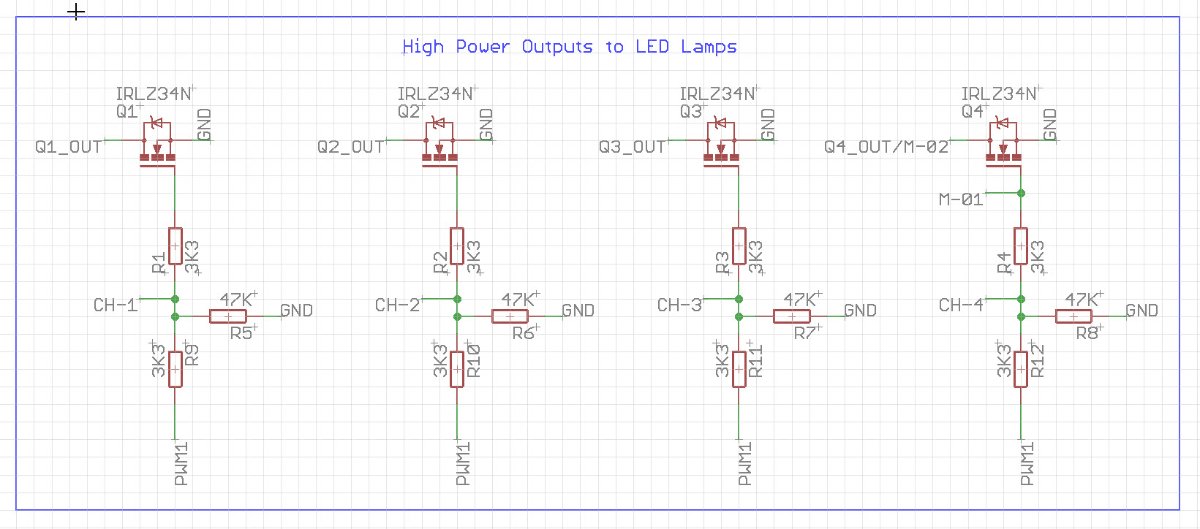

Hi Frank,
The resistance values are wrong, look at the circuit I uploaded.
That's why is not working for you.
The resistance in my circuit between PWM and each channel I have as 3K3.
You have got it as 0R i.e a short.
You will damage the microcontroller as PWM is and output and CH1 is also an output.
When CH1 for example is low (shorted to 0V) , it will disabled the LED, so even if PWM output is high (Shored to 5V).
You are effectively shorting the PWM output!
Instead of NPN bipolars you are using N channel MOSFETS.
I have modified flowchart based on you original based on Original - 0.3.fcfx but with dimming all of portC via bitbang method.
Hopefully it will work for you as rushed it a bit.
When I use a 3K3 resistor (in R25) between the PWM1 line and the mosfet the mosfet does not dim anymore.
I use “TEST PWM PIC16F1788 - 01 - LDR Treshold in Macro.fcfx”
- Posts: 9521
- Has thanked: 2585 times
- Been thanked: 3815 times
When using PWM component, the channel that is connected to each pin needs to disable only.
Therefore the LED should be off.
So when the LED is to be on the channel needs to be turned to an input.
Then the PWM is allowed to control the LED.
Therefore you have to alter flowchart accordingly.
If you are struggling with that I can modify when get a chance.
Hi Frank,
Try the attached Flowchart.
It's using one PWM component which of course is common to all channels.
I have set the min PWM to 60%
Port (0 to 7) is used for each channel.
Don't forget R25 must be at least 3K3 for each channel.
If it does not work for you, then I will try on hardware when I get a chance.
- LDR TEST - 4 PWM component.fcfx
- (17.05 KiB) Downloaded 14933 times

Can you disconnect a channel and see if LED connected to the channel flickers?
The only thing I can suggest is short out the resistor from channel to gate.
Make sure the resistor between PWM output and channel is high enough to prevent excessive current. 2K2 to 4K7?
Are you able to scope the voltage across gate & GND and across LED that's flickering?

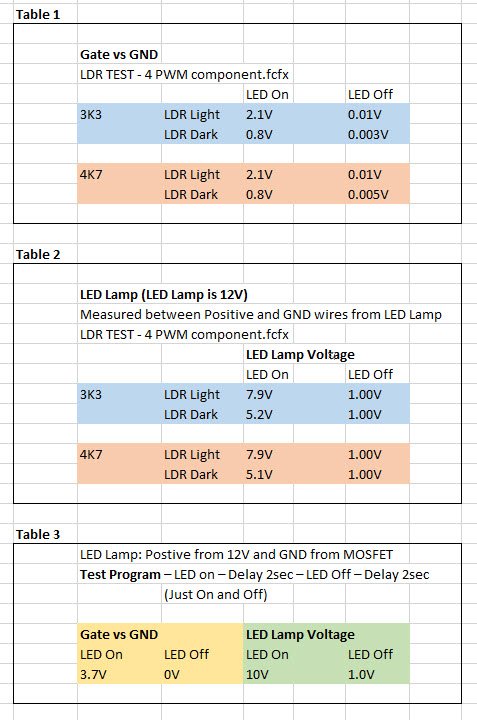

I have done some measurements and came to the following conclusion. (Measured with a SDM 3055)
The power lines have thick wires, not breadboard wires.
I have only test it with 1 channel.
I need in daylight 12V on the LED Lamp. If you look to Table 3 than the LED Lamp gets only 10V because the Gate from the mosfet gets 3.7V from the PIC. For me this is strange because the PIC runs on 5V. But that is something to me to find out why.
Table 1 and 2 shows the program “LDR TEST - 4 PWM component.fcfx”
To be sure: I have used in all measurements an old school 35m photo film box and a led torch.
(The colors in Table 1 and 2 are a reference.)
Hi Frank,
You not got a scope or logic analyser?
You are measuring the average voltage, wharas im intreasted in the whole of on/off waveform.
You need to remember that when the LED is on, it is actually being pulsed as a frequency of 1KHz.
Are the MOSFETS logic level types?
There will be a drop in voltage at the gate due to 27K Resistor connected to GND (along with 3K3 connected to PWM output) and also the output is a PWM with a variable duty.
(I have FlowCode 8 )
I will come back to this topic. I've been helped a lot but it still doesn't work properly.
This concerns four Road Safety Lights (LED 200mm) This lamps are full of lenses, so every flicker is verry noticeable.
When it starts to get dark, the lamps flicker when they are dimmed by the LDR. The flickering is minimal but very noticeable.
Each LED lamp has its own MOSFET (Logic Level IRLZ34N) The circuit diagram is simple:
ON: LED 1 and 2: 1 second
OFF: half second
ON: LED 3 and 4: 1 second
OFF: half second
Repeat
The LDR is an NORPS-12 with a 10K resistor.
What could this be due to? Maybe it should be completely different with different hardware (CPU and more). I've been working on this for a while now but can't figure it out.
I hope there is still someone who can help me with this.
