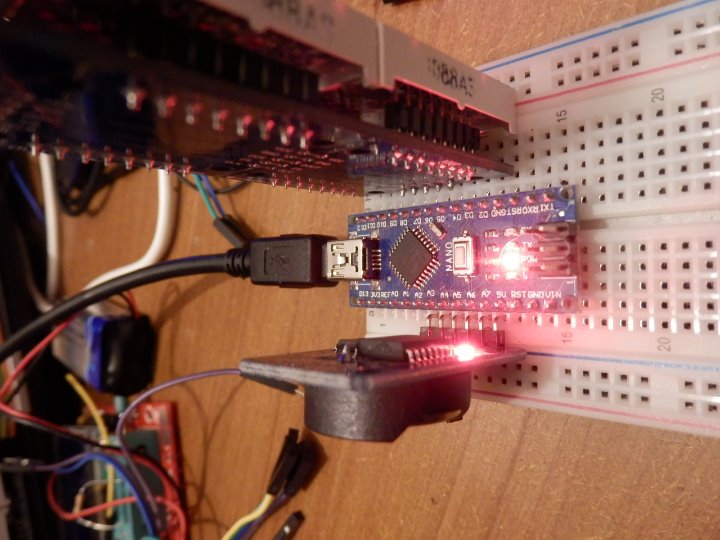

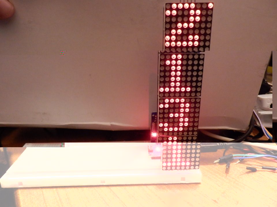

I created a 'tower' clock using an Arduino Nano, a RTC (DS3231) and a 4 x8x8 Max7219 display.
I noticed that the RTC board could plug in opposite pins A2 to A7 and SDA and SCL would be next to the corresponding Arduino pins (A4/A5). I thought a five jumper clock was on the cards - but no. Plugging the matrix display into the breadboard (opposite pins d5..d9) - and (although it's probably pushing the current allowance for an Arduino pin a bit) worked fine. So using A2/A3 to power the RTC and D5/D6 to power the display.
Presenting the ZERO jumper breadboard tower clock :D
tower clock.fcfx
(12.4 KiB) Downloaded 744 times
Seconds are displayed as a moving dot on the right of the display - and in the tradition of quick and dirty hacks - I use the redrawing of the time to erase the 'seconds' dot.. I also haven't tested it at the crucial rollover points (am - pm etc). Jazzing it up is left as an exercise to the reader!
