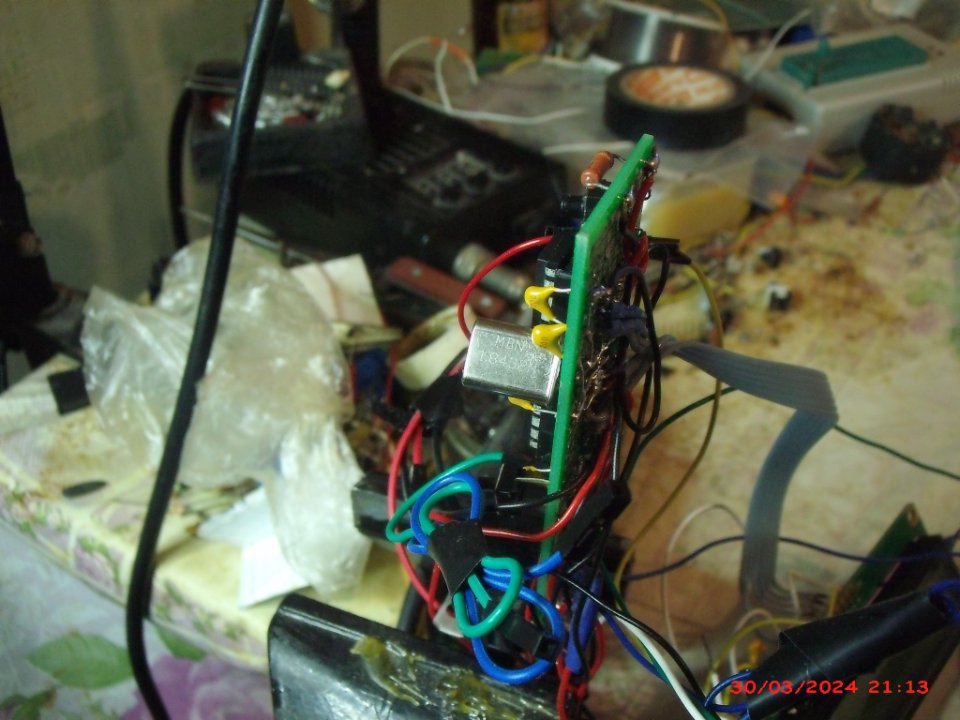

Re: Download the program for the device via the Internet.

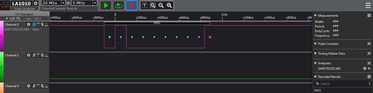

Good evening! Today I connected 1.8432Mhz quartz and two 20 pf capacitors to the controller of the transmitter and receiver of uart bus signals. It got a little better to accept, but it's still bad: out of 25 numbers, as many as 6 numbers were incorrectly accepted!

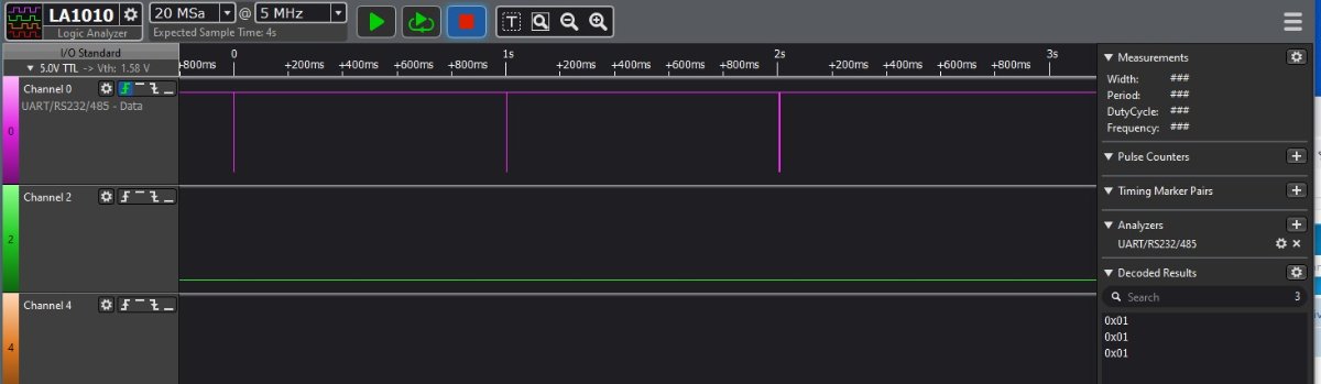

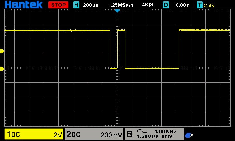

Good evening! I changed the programs a little-now data is also being sent via an interrupt. The results are slightly better: once I transmitted 25 numbers and there was 1 error, another time I transmitted 25 numbers and there were 6 errors. In the attached files, the voltage at the TX pin of the rs232 bus is without distortion.
- send 1 get 1oscilloscope resolution 200 µs.jpg (55.12 KiB) Viewed 35946 times

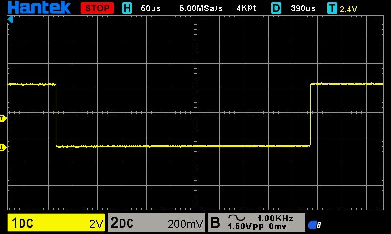

More signal graphs.
- send 4 get 22 oscilloscope resolution 50 µs.jpg (53.51 KiB) Viewed 35946 times
- send 3 get 247 oscilloscope resolution 100 µs.jpg (54.1 KiB) Viewed 35946 times
- send 2 get 26 oscilloscope resolution 200 µs.jpg (54.55 KiB) Viewed 35946 times

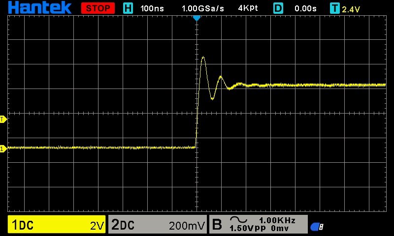

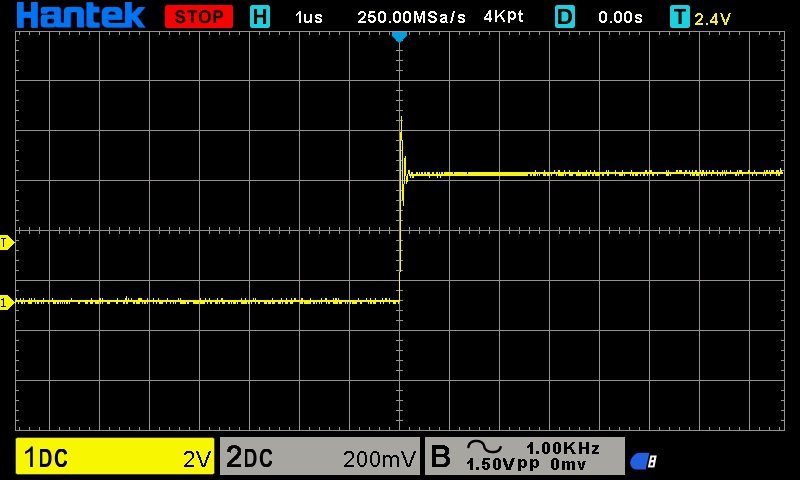

More signal graphs.No special distortions were found.
- send 9 get 237 oscilloscope resolution 20 ns.jpg (54.51 KiB) Viewed 35945 times
- send 8 get 14 oscilloscope resolution 100 ns .jpg (55.24 KiB) Viewed 35945 times
- send 7 get 191 oscilloscope resolution 1 µs.jpg (54.33 KiB) Viewed 35945 times
Interesting traces.
Sorry for not replying to things sooner, just been a bit busy. I should get back to you regarding things over the weekend.
Interesting traces.

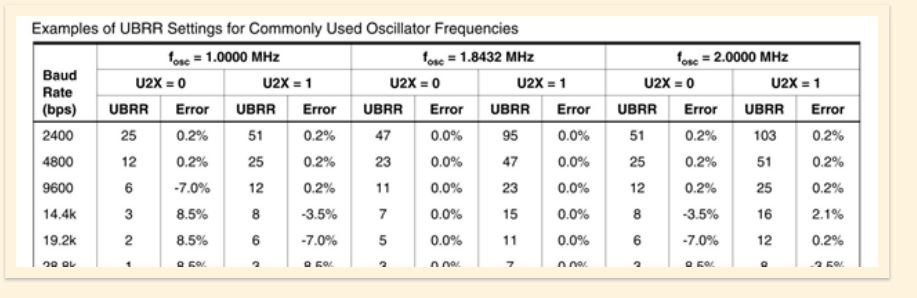

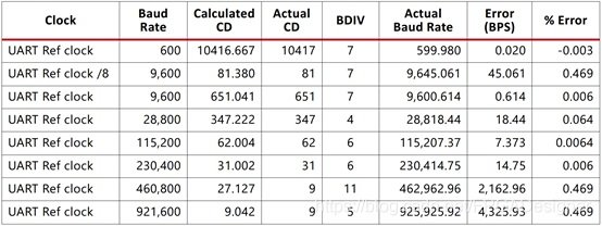

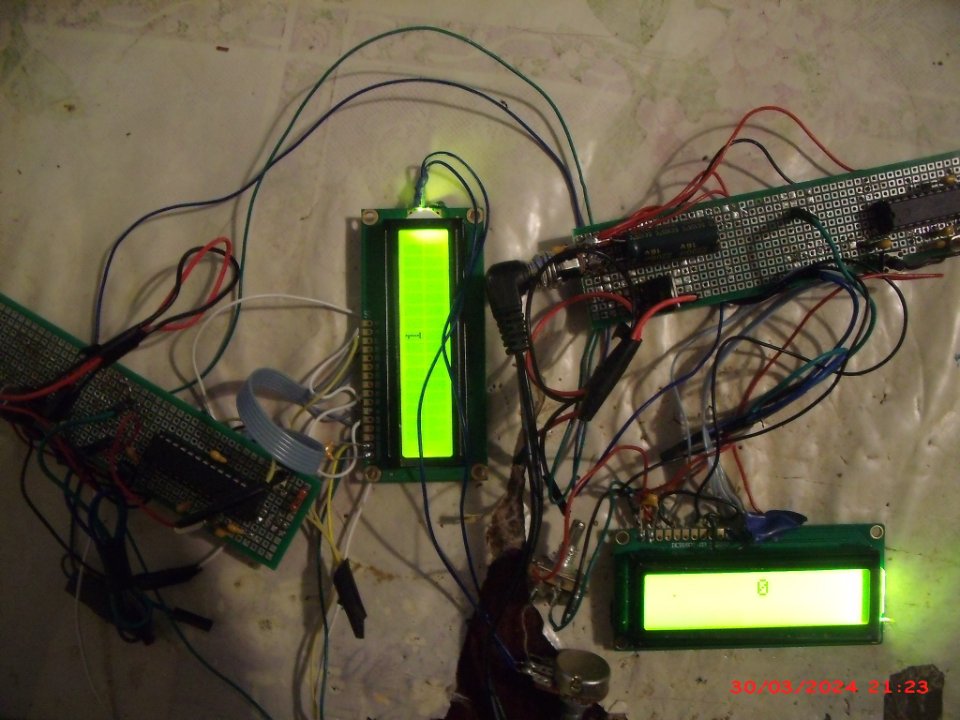

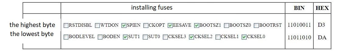

Good afternoon! I found information that quartz 1.8432 MHz is very suitable for data transmission over the uart bus. This is due to the fact that when transmitting a signal, the frequency is divided by 16: 1843200/16= 115200, and to get a transmission rate of 9600, a WHOLE division coefficient of 12 is used. In addition, there is information on errors at the frequencies used.
- 20190325205317977.jpg (35.73 KiB) Viewed 35858 times
- 2.JPG (44.65 KiB) Viewed 35858 times
- 1.JPG (136.5 KiB) Viewed 35858 times
The speed is more than fast enough for 9600 Baud, my comment was really for anything else you may be doing that may benefit running a faster clock.

Even if you remove your 500mS delay you still have a whopping three seconds where you loop whilst repeating your send before you sample the button again, so if you are still getting random transmissions you really need to check your physical circuit to see where the random transmissions are coming from.
Just a thought, are you sure you have the 1.8xxx MHz crystal connected and not accidentally mixed it up with an 8MHz or the like? That would make everything run over four times faster than expected.
I'll look at your latest charts later.
Then you must have a very serious debounce problem or the button is sticking. Perhaps use your scope on the button?In the program, I have a delay after counting 500 ms, so that when pressing the button, only one pulse is guaranteed to be sent, and not several. If you put 50 or 100 instead of 500 ms, when you click on the button, the count will happen very quickly and chaos may occur when sending numbers.

Without knowing your scope setup / triggering etc all I can say is that some traces look close to a baud of 9600 but are too short to see any multiple transmissions.
If you send 0x55 /Dec 85 / ascii "U" that will give you a binary of 01010101 which should allow you to accurately measure bit periods which may help you establish the accuracy.
You say you get multiple transmissions if you omit the 500mS delay, but your charts don't suggest this is possible so you need to rule out anything physical. Perhaps connect one channel of your scope to your button and trigger on this, with the other capturing your Tx pin. Note the point is really to see button activity vs transmission, not capture bits so your time base should be long enough to capture Tx activity after the button is pressed.

I took one of your send charts and modified it to work with some hardware I have. Changed chip too but essentially it is your chart (attached).
No issue at all when sending, all good.
Note that the Tx is also exactly what the Rx is seeing too.
However I did see some strange behaviour in the Rx charts. I would on occasion get a random character displayed, but the analyser connected to the Rx pin proved the character was not sent by the Tx circuitry.
I'll have a further look when I next get some time.

As for quartz resonators, I am sure exactly to the extent that one can believe what is written on the side of the resonator.
I will definitely try your option of sending the number 0x55 . I will write the results and pictures from the oscilloscope screen a little later.
I really liked the screenshots with your signals, does it show in some kind of simulation program? I wrote to you a long time ago that I already had experience sending and receiving data over the rs232 bus, but then I only limited myself to the simulation program. Everything was fine there. But in the real scheme, not so much.

Good evening! I am sending you photos of both boards with quartz resonators.
- 2.jpg (122.06 KiB) Viewed 35775 times
