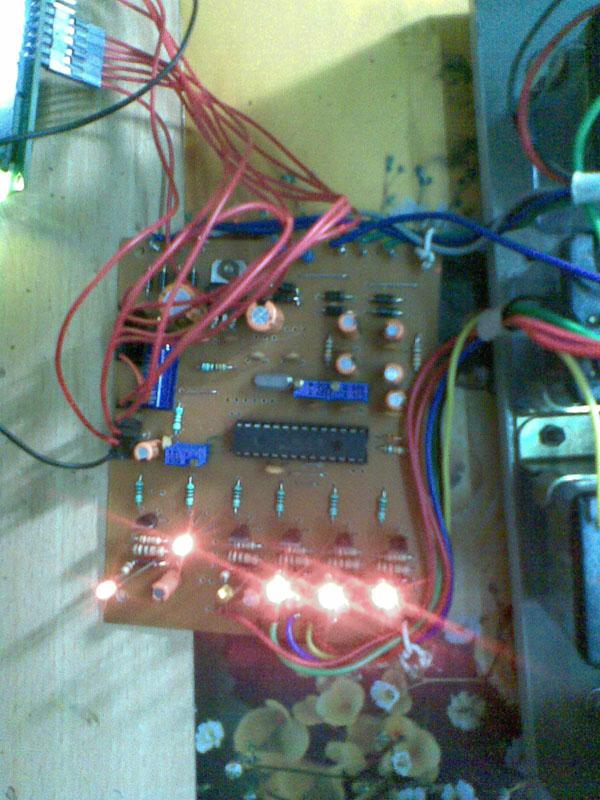

I am sending 3 images of my 0.6KVA model, it is almost complete, it is a demo model. One problem is in LCD Display.
The 3rd digit/number flickers (frequently changing the value) and some times at power on the LCD don't shows the value.

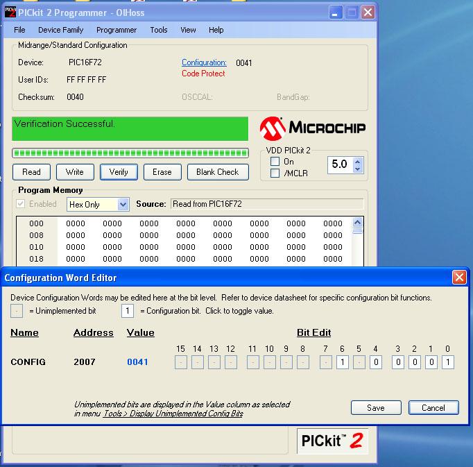

I have Config the chip as per the image posted by you and burn the chip. i don't find any major difference, but there is a slow power on at start up, what i see.
In Mazidi book " PIC Microcontroller and Embedded System"
CONFIG2L Register
bit-0 is PWRTEN bit, which is Power-up Timer Enable/Disable bit, Active Low
bit-1 is BOREN bit, which is Brown-out Reset Enable/Disable bit, Active High
bit-2-3 is BORV0-BORV1 are Brown-out Reset Voltage bits
11= set to 2.0v
10= set to 2.7v
01= set to 4.2v
00= set to 4.5v
I am little confused, shall i use just bit-0 and bit-1 or bit-0 to bit-3?
I am attaching the image of my PICKIT-2 Config window, please look at it and suggest.
CONFIG2L Register
11= set to 2.0v
10= set to 2.7v
01= set to 4.2v
00= set to 4.5v
With best regards
sks
- Config_01.jpg (103.17 KiB) Viewed 13550 times

I don't know which chip you are looking through in the book you mentioned..But PIC16f72 will not allow you those..as the datasheet says the following: But what you have mentioned available in other lots of chip. But not available in PIC16f72..Can you please confirm which PIC is have that config2L..as PIC16f72 don't seems to have that. Address is 2007h as you have shown rightly for PIC16f72 and config register is fine and matches ok with flowcode config.bit-0 is PWRTEN bit, which is Power-up Timer Enable/Disable bit, Active Low
11= set to 2.0v
10= set to 2.7v
01= set to 4.2v
00= set to 4.5v
Edit: I have checked your config in PICKIT-2..that's right and perfect..so please tell your problem.

I guess you actually mean that there is no such difference..that's right..slow start up caused by PWRUPTMR..that's good. Brownout is not visible but it makes circuit reliable.i don't find any major difference, but there is a slow power on at start up, what i see.
I will post program to sort this LCD flicker issue..But what it shows somethime at powerup? Black blocks?The 3rd digit/number flickers (frequently changing the value) and some times at power on the LCD don't shows the value.

If i should stick to Flowcode config parameters, i will, i will not see the config option of my Programmer, what do you say ?
I just want to know, there is absolutely no problem. I have told you the result and you have described
"slow start up caused by PWRUPTMR..that's good. Brownout is not visible but it makes circuit reliable. "
Thanks.
"what it shows somethime at powerup? Black blocks?"
Yes, showing Black blocks.
With best regards
sks

As I can see the PICKIT-2 is just showing what you set in Flowcode so I would suggest you to just stick to Flowcode.If i should stick to Flowcode config parameters, i will, i will not see the config option of my Programmer, what do you say ?
This is probably due to transformer hamming noise spike at the beginning which might be avoided by delay in the beginning to start LCD. You can try adding 1 sec delay in code before LCD start to see how it behaves.Yes, showing Black blocks.

Now i am posting a code with the Relay logic Table, please see, this code is not working properly.
This time please tell me what is wrong in the program.
With best regards
sks
Thanks for the reply. OK, i will follow the Flowcode config. I will take care the LCD issue and post the result.
With best regards
sks

Re: Automatic Voltage Regulator (AVR) using PIC16f72
Ok..I have changed two things among that one is minor but other is major..Minor is:
I have used masking in PORTB and sent data in all masked bit not individual bits as that save flowchart space and some clock cycles of pic.
Major is: Your decision branches were executed one after another like...if USE_AN0>=200 do one thing but if USE_AN0<=185 do another..that's fine but if you have similar if else in the same tree they will be executed one after another and Relay will be chattering according to each command. I have arranged the decision in such a way that only one decision will be executed depending on voltage and will be in that branch until voltage changes.
Hope it make sense.
Hope it make sense.
Dear Mr Enamul,
Thanks for pointing my errors on the code, and elaborating corrections you have made in details.
Now i understood.
Yes the Relays were chattering. Now it is alright.
Some errors are there, i have to check in details, whether its a hardware error or a software error, then i will post the result.
With best regards
sks
Now i understood.
With best regards
sks
Yes you are right. There are some hysteresis issue in relay switching. In some voltages relays remain off I guess..This is sorted now.Some errors are there, i have to check in details, whether its a hardware error or a software error, then i will post the result.
