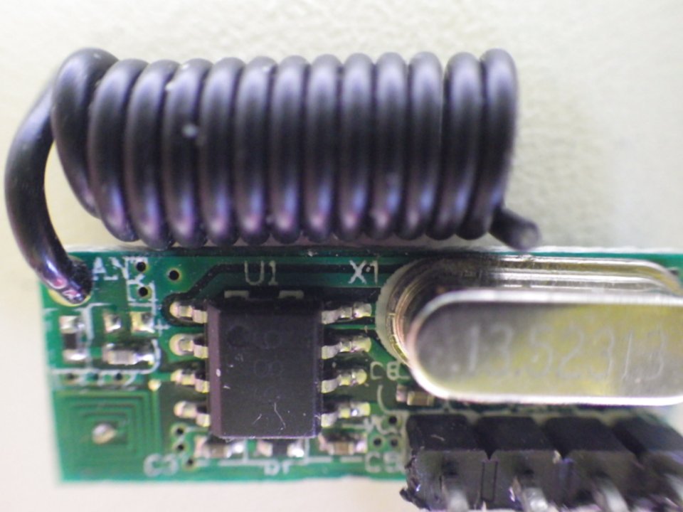

Can you please publish a photo of your module?
Is it a Rx only module?

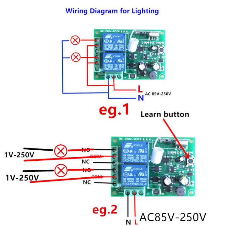

Got any vinegar? As per my moniker the chips are well and truly fried......
The unit is from Qiachip (https://qiachip.com/) and is a two channel 220v controller https://qiachip.com/collections/ac-powe ... els-module
I am, or was going to use it to control a roller shutter.....
In a lapse of sanity I accidentally shorted out part of the board.... Cat wasn't best pleased with the bang
I then removed what appeared to be the RF unit which is marked RX217E and had +ve / -ve / DO markings on pins. The only chip was I assume OEM, marked 9080. Connecting DC across the terminals with a scope on DO showed a flat trace so I'm guessing I made a good job of destroying things.
Another on order.....

Accidents... What can you do...
Can you please have a look at the Rx module chip?
I tried to find out on the web-site, but failed.
Is it SYN470R?
Is it SYN470R?

The board (KR2202) came as a complete control unit based on 1527 and appeared to have a small RF module attached at top right. After I blew it to bits I removed the RF module in the hope it could be recovered. The 90 degree headers were solidly jammed into the PCB holes then soldered (holes are probably a drill size too small). Freeing the module took considerable physical effort and it could have sustained damage in my doing so.
There is a single chip marked 9890, a crystal with the odd discrete or two. Unfortunately I don't know what the board outputs, RF or digital but I suspect it isn't RF.
The main board has a couple of chips which appear to be the brains of the unit marked (I think) FMD B2J4RKE and LK22221. Unfortunately I can't find any information for any of them. However the RF DO pin connects to Pin-2 of the FMD B2J4RKE so I guess it is doing decoding.
Kaboom
When I get the replacement controller I might gingerly have another poke..
EDIT...
New controller arrived and the DO output on the RF board is digital, therefore all RF processing is handled in the module by the 9890 chip. Output is high until it receives a transmission. I might connect a hand held scope if I get time, as I'm a bit wary of connecting anything that's actually grounded to this.
Kaboom
EDIT...

Re: There is a single chip marked 9890, a crystal with the odd discrete or two.
I think it is a decoder chip. Probably not 9890, but 9896.
Re: Unfortunately I don't know what the board outputs, RF or digital but I suspect it isn't RF.

Tx, Rx kit
I think you have two Rx modules.
One Rx module has two relays ( the one you need to control an AC motor).
You need another module -> the Tx module (button).

You could be right. That chip is very possibly 9896, the writing is so very small and it appears to do everything regarding processing the RF signal and outputting a digital pulse. Without a scope on the pin I can't say for certain what it actually outputs when receiving however it is a stable High (+5v) in standby, dropping Low (approx 2.2v) during reception (as measured on a multimeter which obviously can't respond fast enough).
Quite correct in that I have two transmitter units too (well, four now
), but didn't mention them. Very easy to pair and set up the controller to respond how I wish. I have the two relays toggling depending on button pressed ("A" = Relay 1 On, Relay 2 Off/ "B" = Relay 1 Off, Relay 2 On)
I'm more annoyed at destroying the RF module itself than the whole controller though, as it seems a capable little board.
Charging up my hand held scopes so hopefully I can capture the DO pin. Not sure if the batteries will hold a charge though.... it's been a while.
