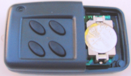

Here two more pictures of the case.
In this is shown the hole of the IR Led in detail
In this is shown the home made sticker.

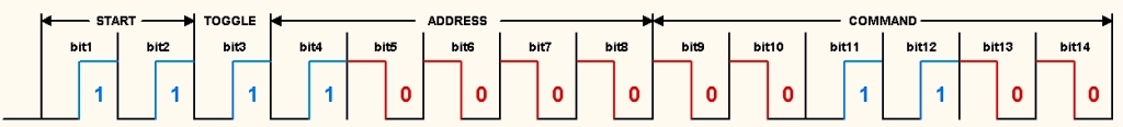

A small tutorial about RC5 protocol: Each transmitted packet is formed by 14 bits. The time of each bit is 1.776msec. Each bit is biphasic which means that changes state in the middle of his time, with other words a bit is considered as logic “1” when for the first 888μsec (1.776msec / 2) is LOW and for the next 888μsec is HIGH and vice versa.
The two first bits of packet are the START bits and are always “1” and used from the RC5 receiver IC for AGC. The 3rd bit is the Toggle bit and used from the receiver to recognize if a button on the transmitter is firmly pressed or is repeatedly pressed. That is useful for some functions. Each time we press a button on remote control handset, the Toggle bit changes state. The next five bits constitute the RC5 address code. Each address code is used by the RC5 receiver to detect whether the received packet is for his own use. For example, according to RC5 protocol system, the address code 16d (10h) is dedicated to “audio preamplifier 1”, the address code 19d (13h) is dedicated to “audio preamplifier 2” and the address code 0d (0h) is dedicated to “TV set”. The last six bits constitute the RC5 command code. Each command code is used by the RC5 receiver to activate a concrete function. There is a table of RC5 protocol where is explained in which function is dedicated each command code.
In the first post, we have seen how the RC5 packet modulates a 36KHz carrier frequency and how is transmitted. We will now see how a RC5 packet can be formed to provide a modulation signal, through the use of common Flow Code icons and some logical operations between variables avoiding thus the use of C code and macros.

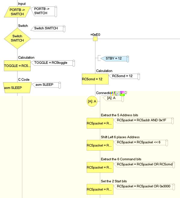

The entire process occurs within the MAIN Loop, starting from the “switch SWITCH” icon where verified which button has been pressed. Remember that all buttons are “active LOW” and when pressed drive the corresponding input in LOW state. First of all, suppose that the RC5 Address has already initialized to the value 16d = 0x10h. Suppose now that the button STBY has pressed, then in Port B register is written the binary number 1110 0000b = 0xE0h that is transferred into variable “SWITCH”. This number is verified into “switch SWITCH” icon and the program flow is turned to the first branch “0xE0” or “STBY = 12”. In the first Calculation icon the variable “RC5cmd” gets the corresponding value 12d = 0x0Ch:
RC5cmd = 12
In the next Calculation icon the five Address bits are extracted into variable “RC5packet”. The variable “RC5packet” is defined as integer type and has a length of 16 bit:
RC5packet = RC5addr AND 0x1F where 0x1Fh = 0001 1111b and RC5addr = 0001 0000b, so the result of calculation will be: RC5packet = 00 0000 0001 0000 (0x10h)
In the next Calculation icon the last 5 bits of variable RC5packet are shifted LEFT by 6 places. In this way, the 5 Address bits take their position provided by the RC5 protocol into the RC5packet and leave free the last 6 positions for the 6 Command bits:
RC5packet = RC5packet << 6 and the result is: RC5packet = 00 0100 0000 0000 (0x400h)
In the following Calculation icon the 6 Command bits are extracted into variable “RC5packet”:
RC5packet = RC5packet OR RC5cmd where RC5cmd = 12d = 00 1100b and the result is now: RC5packet = 00 0100 0000 1100 (0x40Ch)
In the next Calculation icon the 2 Start bits are set:
RC5packet = RC5packet OR 0x3000h where 0x3000h = 11 0000 0000 0000b and the result is: RC5packet = 11 0100 0000 1100 (0x340Ch) Then it follows the “switch TOGGLE” icon where is examined the state of variable “TOGGLE”. Let’s take a look on the history of this variable: Suppose that the STBY button has been pressed for first time after a general Reset of the micro. In the beginning of Flow Chart all variables are cleared and so the “TOGGLE” = 0, a value that is verified into “switch TOGGLE” icon and so the program flow is turned to the first branch “= 0x00”. In the Calculation icon the Toggle bit of RC5 packet is Set and then the variable “RC5toggle” is also Set:
RC5packet = RC5packet OR 0x3800 where 0x3800h = 11 1000 0000 0000b and the result is: RC5packet = 11 1100 0000 1100 (0x3C0Ch)
RC5toggle = 0x01
In this picture is shown the shape of the complete RC5 packet, ready for transmission: If the STBY button is firmly pressed the program flow always pass through the same branch “0xE0” of “switch SWITCH” icon. Therefore the variable “TOGGLE” keeps its initial value = 0x00h and the program flow pass again through the same branch “0x00” of “switch TOGGLE” icon and both “RC5packet” and “RC5toggle” variables are not changed. If the STBY button is released then in Port B register is written the value 1111 0000b = 0xF0h which is also transferred to the variable “SWITCH”. The new value “SWITCH = 0xF0” does not match with any of the 4 branches of “switch SWITCH” icon, so the program flow follows the straight branch where the variable “TOGGLE” gets the value previously stored into variable “RC5toggle” = 0x01 through the Calculation icon:

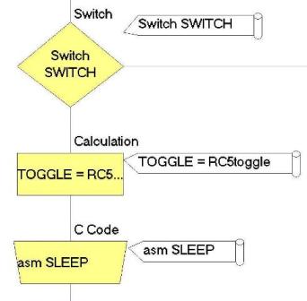

TOGGLE = RC5toggle and the result is: TOGGLE = 0x01h Then, if the button STBY pressed again the program flow will follow the branch “0x01” of “switch TOGGLE” icon and the RC5 packet toggle bit will be cleared, as well the “RC5toggle” variable:
RC5packet = RC5packet AND 0x37FF where 0x37FFh = 11 0111 1111 1111 and the result is: RC5packet = 11 0100 0000 1100 (0x340Ch)
RC5toggle = 0x00
This is the way in which the Toggle bit holds or changes its value.

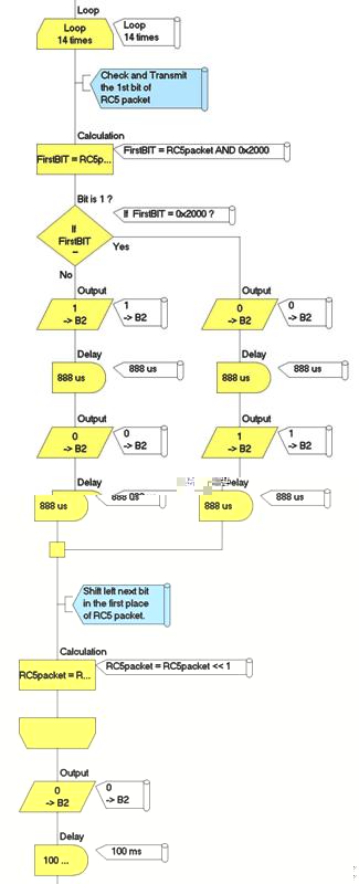

Having completed the description of Toggle bit in detail, we can now see the final stage of the complete RC5 packet transmission. From the first post, we should remember that as input of the Data Signal Modulator has been selected the “MDMIN” pin which is assigned to the Port RB.2 of micro. To this, the RC5 packets will be transmitted at the same Port.
The transmission takes place inside a 14 times repeated Loop, a number that corresponds to the 14 bits of RC5 packet. Within the Loop, the first (MSB) bit of RC5 packet is masked, its value is verified and stored into variable “FirstBIT” and then is transmitted:
FirstBIT = RC5packet AND 0x2000 where 0x2000h = 10 0000 0000 0000.
Then through the Decision icon “If FirstBIT = 0x2000?” and according to the value of the first bit of RC5 packet (i.e. MSB = 0 or 1?) the program follows the corresponding branch. For example, the first bit is one of the two Start bits which always are “1” so the variable “FirstBIT” = 0x2000 and the program flow follows the YES branch of Decision icon. Now we have to transmit a Logic “1” bit. We have seen that the RC5 bits are biphasic, so the first half of the bit must be transmitted as “0” while the second half as “1”. That is obvious in the YES branch, where a “0” is immediately transmitted through the Output icon “0-->B2” that Clear the Port RB.2. The “0” transmission should last for the half time of bit (1.776msec / 2 = 888μsec) and this obtained through the Delay icon “888μs”. Then the Port RB.2 is Set through the Output icon “1-->B2” and this state last for the rest time of bit through the next Delay icon “888μs”. Here the transmission of the MSB bit of RC5 packet is completed and now is time for the transmission of the second bit. To this, the bits of RC5 packet are shifted Left by 1 place, so that the second bit will take the place of MSB to be verified if is “1” or “0”. That is obtained through the Calculation icon:
RC5packet = RC5packet << 1
Then the process described above is repeated for 14 times and thus all bits of RC5 packet are transmitted one by one.. When the Loop Count = 14 is completed, the program flow exits from the Loop and the Port RB.2 is Cleared through the Output icon “0-->B2”.
The Delay icon “100ms” at the end of branch exists to fulfill a rule of RC5 protocol: Successive RC5 codes (or packets) must be repeated in time intervals no less than from (4 X 16 bit-times) or: 4 X (16 X 1.776msec) = 113.664msec. If we subtract the time of the 14 bits of each packet: 113.664msec – (14 X 1.776msec) we led in a distance between the end of a RC5 packet and the start of the next RC5 packet of 88.8msec. That helps a lot the RC5 receiver to synchronize with the start of the RC5 packet received. A delay time of 100msec between successive packets is very safe for a correct communication.

Hi!bercioiu wrote:Thanks for your reply!
In the mean time, I manage to alter your original flowchart with RC5 component and its working ok!
I want to make a remote control with 6 buttons and I chose pic16F1828 too but my program doesn't run!
I post my fcf file and please, when you have time, to correct my code.
Regards.

Re: Remote Control Handset "1"
Hiplstryagain wrote:Hi!bercioiu wrote:Thanks for your reply!
Regards.
Try the attached fcf and don't forget to get the modulator output - which must be connected to the base of transistor - from the port RC.4
- RemoteControl (1).fcf
- (29.09 KiB) Downloaded 1048 times
Best Regards FOTIS ANAGNOSTOU
Thank you very much, Mr fotios!fotios wrote: Hi
Regards!
