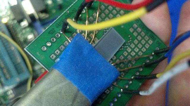

Hi Guys, I have been having a lot of fun with SMD pics! Here are a few pictures of the fixture I made to do it. It works great and I have yet to have a failure. Ben gave me a sketch with the pins that are actually needed but I could not see exactly how it should be hooked up so I just hooked up all 8 pins with short leads. Could someone clear up which pins are needed and where they would go with only an 8 pin pic? I have also been flowing my own boards in an toaster oven that I modified with great success but that’s another topic. I used a spring clamp to lock the pic down.
2012-08-27 16.23.55_640x360.jpg (45.14 KiB) Viewed 4175 times
2012-08-27 16.25.55_640x360.jpg (55.76 KiB) Viewed 4175 times

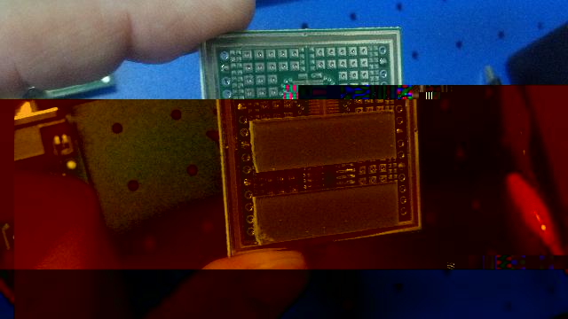

More pics
This is the place I purchased these little SMD proto boards: http://protoboards.theshoppe.com/tinychip2.html
2012-08-27 16.20.24_640x360.jpg (41.17 KiB) Viewed 4174 times
2012-08-27 16.20.32_640x360.jpg (49.6 KiB) Viewed 4174 times
2012-08-27 16.23.03_640x360.jpg (41.12 KiB) Viewed 4174 times

For 8 pin devices:
The connections you are interested in are:
VDD = +5V = pin 1
VSS = 0V = pin 8
VPP = High programming Voltage = pin 4
PGD = Programming Data = pin 7
PGC = Programming Clock = pin 6
