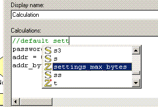

As an update request: It could be great if variable advices won't appear when I write comments. ;)
Thanks.

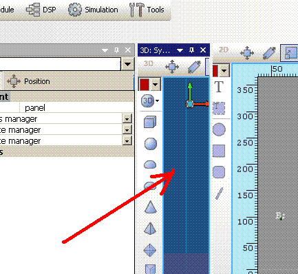

Small issue with 3d System panel.
I closed it and work with 2D only, but every time I start FC and open my project, 3D panel is back to it's place.
FC 6.1.3.2 (18.02.2016)

Hi mikn,
That doesn't sound right - we'll take a look at the new routines that memorise the window positions and see if we can identify the problem.
In the mean-time, if you only ever want to use the 2D panel, you can completely disable the 3D panel in the global options....
- Open the menu item "View -> Global Options"
- Click the "Application" tab.
- You can now click the option boxes for "Use dashboard as the default panel", and "Disable the system panel".
If you do this, you will also find that you can get components onto your panel a little faster by just double clicking them in the menus without needing to drag them across the screen - normally this would make them appear on the System Panel (3D).
Best Regards,
Steve.

The scope window pop up is annoying at best and should be removed from the components in the next update release. I've added this to my list to double check it gets removed.
