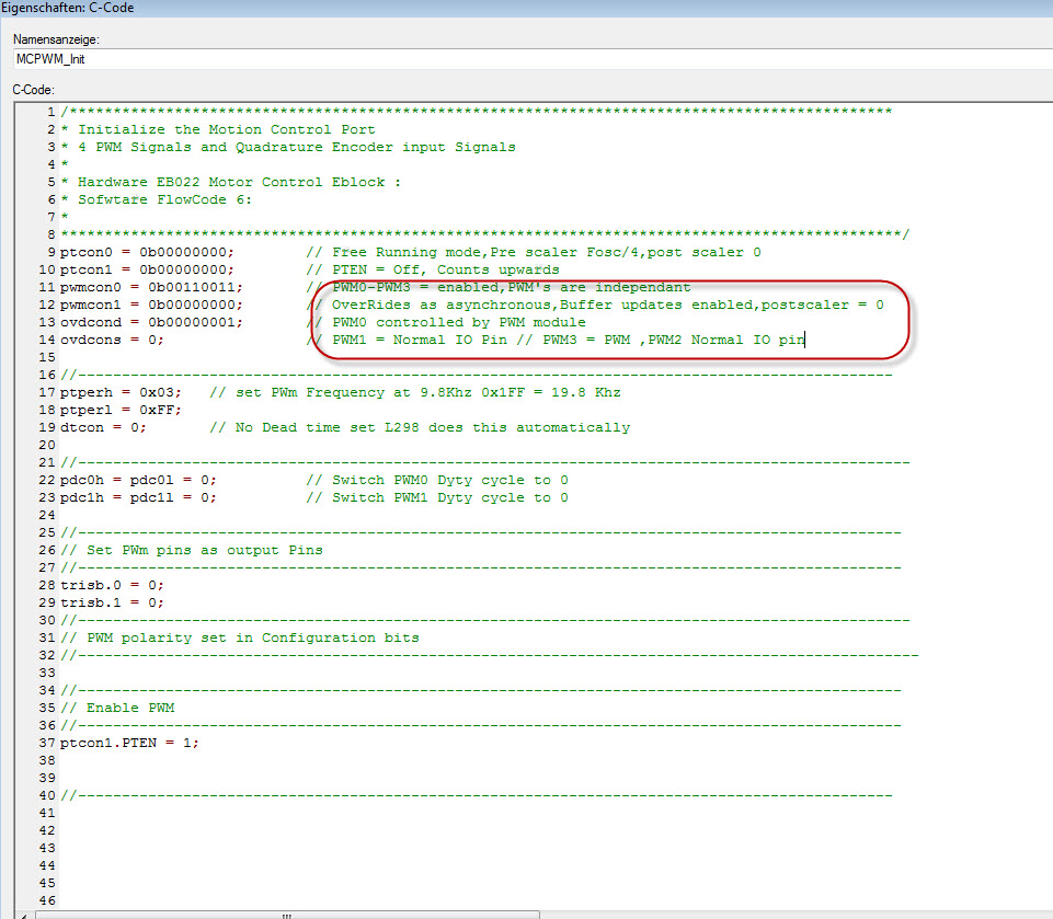

@Benjadvanced PWM peripherals cannot even be enabled individually.

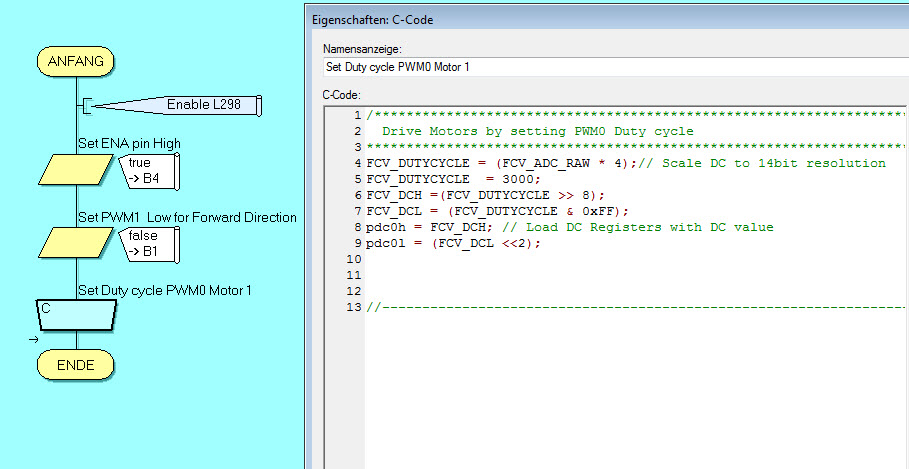

I am not a 18F1330 user however I use the 2431and 4431 and the 4331 a lot and I use single PWM on this device by setting the OVDCON and OVDCONS registers and by setting the Pins to individual mode
I apologize if i misunderstood your post only say that on the above devices I run single or 4 PWM with 4 IO on the other PWM pins or in the pair modes as decribed in the data sheet,the only problem as you mentioned is that you have only 4 Duty cycle registers I am actually running a small demo on your EB006V9 and EB022 with a PIC18F4431with PWM on only PWM0 and PWM1 is a normal IO pin
You will notice below PWM0 is a PWM channel and PWM1 normal IO pin and set low ,PWM4 is also a IO pin and sets the Enable Pin on the L298 driver high and in the C file the duty cycle for PWM0 gets adjusted

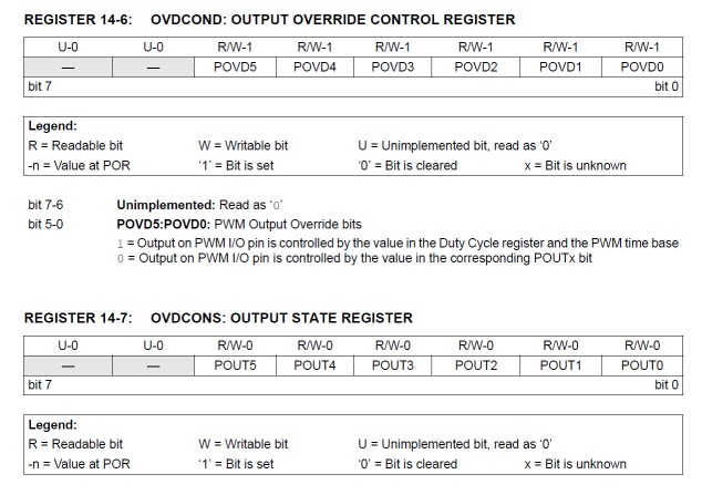

I just had a look at the datasheet of the 18F1330 and it has the same power Control module as the PIC18xx31 and in my opinion it is possible to run individual PWM pins or the pair combinations as for the advanced PWM schemes
the OVDCOND register allows you to achieve the individual pin PWM ,however1- 4 individual with independent Duty cycle same Frequency or 1-8 individual PWM's with 4 different Duty cycles (2 PWM's per Duty cycle register )for the devices with 8 PWM pins and 1-6 and 3 Duty cycles for the 6 PWM pin devices
@nicmaes you can probably just modify my configuration to suit your pins
Good luck
Good luck
