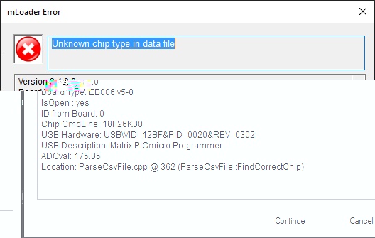

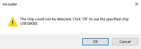

Using Mloader and trying to program a PIC18F26K80 i get the following message
Using a PIC16F88 and it works ok.

mLoader does not support the k80 at the moment and I cannot test it here because I do not have any of those chips, but I have tried to guess the fix...
If you use the attached files instead of the ones in the mLoader directory then it might work, but I cannot guarantee it.
If you do try, please make a copy of the original files and also let me know how you get on. If it works, we will add the files to the next update of Flowcode.

I have transferred over the files and tried programming the chip but get this message now.
There is no rush for this , its something i found and thought i would let you know.
