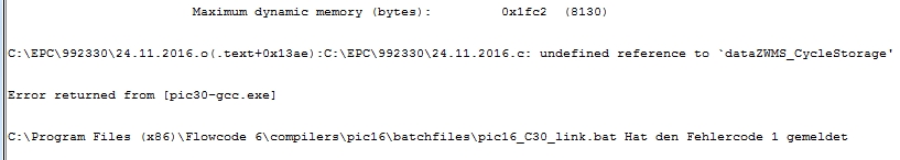

I have FLOWCODE 6 with a PIC24FJ128GA010 (16bit) with this problems:

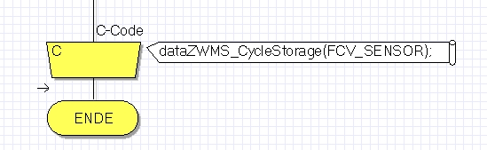

Here, I will open the external code with the macro dataZWMS_CycleStorage
and I will send the variable FCV_SENSOR to the code.
Like this in C-Code show the picture:
dataZWMS_CycleStorage(FCV_SENSOR);
The compiler wrote this error:
undefined reference to `dataZWMS_CycleStorage'
Error returned from [pic30-gcc.exe]
The C-Code was generated but not the hex file.
If I compile the C-Code in MPLAB X IDE, then I have no error and the Hex-File was generated
Who can help me here or has an idea..???
So that the hex-file will generated in FLOWCODE 6

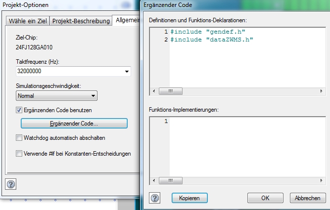

I must send the variable to this code!
Here you can see the the include files:

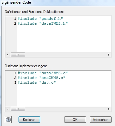

You will also need to either compile and link the external code, or include the source ...

Your idea was good, at the moment without errors :-)
like this, here is the code very difficult :-)
