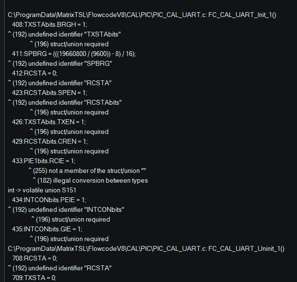

May I request someone to point out the mistake I am doing or there is some other problem. I tried using PIC18F25K42 with one I2C display (gLCD_SSD1306_i2c1), one MODBUS slave and three Analog Inputs, the compilation ends up with errors on contrary if I change the chip to PIC18F25K80 the compilation returns with success.

Kindly excuse for the delayed reply, following your previous post, I uninstalled the FC8, downloaded/installed the FC8.1 and again tried to compile but unfortunately the same error, may I request you to check the properties I have set for the Display as well Modbus and Project Option too.
One more thing I observed, when I select the device PIC18F25K42, the I2C and UART, receives additional pins to select from the drop down menu in the properties window, I think something goes wrong over there, but I do not understand where and why.
Thank you, hear you soon.
Abhi
NOTE: in my previous post (Jan 23rd) the FC for PIC18F25K42, I forgot to change the device to PIC18F25K42 from PIC18F25K80, from the Project Option.

I checked your flowchart and to me there is a configuration/definition error for the chip in Flowcode (cal components).
The team will solve this for you or Martin :D
@Team
below the compiler errors with MODBUS not active only LCD then the I2C errors are shown second time around gLCD not Active MODBUS
errors caused some strange reports :D

The topic is a bit strange. It details the k80 devices and K22 devices but reading the text the problem is with a k42 device. Looks like it's maybe a hijacked topic.
Anyway looking at the K42 device datasheet it looks like the registers for I2C/SPI etc have been completely re-done so we will have to spend some time re-working the FCD and CAL to suit. Do the K22 and K80 devices have similar issues?
