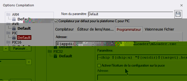

With Flowcode5, you could quickly copy and paste the programming parameters of a chip:
Screen Shot 12-18-17 at 09.14 AM.JPG (103.43 KiB) Viewed 2230 times

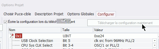

How to do with Flowcode7, the parameter "Download configuration now" is grayed out?
Screen Shot 12-18-17 at 10.41 AM 001.JPG (60.42 KiB) Viewed 2230 times

Re: Manually configuring the chip for PICmicros
Hi Bruno,
The send configuration settings now option is for AVR devices as the configuration settings do not get packed into the output hex file.
For PIC devices the configuration is packed into the hex file for you and so gets assigned when programming the device.
