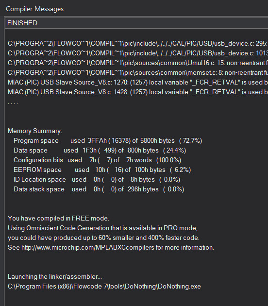

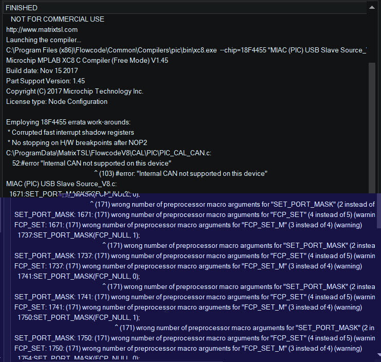

The Miac Flowcode USB Slave Source Firmware Projects compiles fine in FC7 (Leigh fixed the issue about 1 month ago) however the same
Source project in FC8 has multiple errors including a CAN error
FC Compile
FC 8 Complie

Then thinking about it between then and now there were some pic updates not sure exactly what now trying to work in V8, I have this errors as shown,
could there be something in the updates that could cause this :) any case for now I just carry on with V7

The issue is with the CAN component due to some major additions to the SPI component.
I'm currently still working through the CAN.
Will post again when I have it all resolved.
Leigh

The CAN component is now fixed, will be rolled out on the update system very soon 8)
ps. needs updated SPI component too
Re: MIAC USB Slave Source code Error in FC 8
I've pushed out the fix to the update system now, let us know how you get on.
