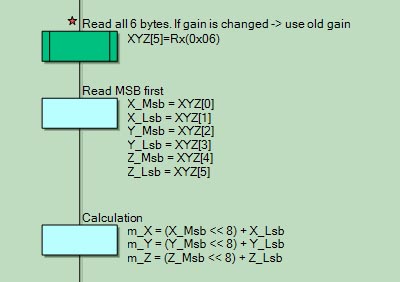

First of all thanks to Ben for creating a HMC5883 component.
This magnetometer HMC5883 has a self-test function.
By trying to do that function I have some problems getting values out of array XYZ[6].
I can see Z values changing, but X and Y returns zero. I am not sure, maybe X and Y suppose to return zero.
Question
Is it a good idea to save the magnetometer readings in one go to an array or read one data register after another?
Is it possible to give an example of reading the magnetometer XYZ data?
Thank you.

Re: HMC5883 Self-Test question
Can you post your program, I think I can see what you have done wrong but need to see the program to be sure.
The UpdateCompassData macro basically collects all 6 readings for you allowing you to then pull out the readings at your convenience.
All at once is faster and therefore probably the recommended option.Is it a good idea to save the magnetometer readings in one go to an array or read one data register after another?
Here's a very brief example.Is it possible to give an example of reading the magnetometer XYZ data?
Thanks Ben
The program is attached.
- HMC58883Test_2.fcfx
- (42.64 KiB) Downloaded 185 times
Ok you were only reading a single register before and storing into XYZ[5].
I've changed this so now you read all 6 registers and store into XYZ[0]-[5].
