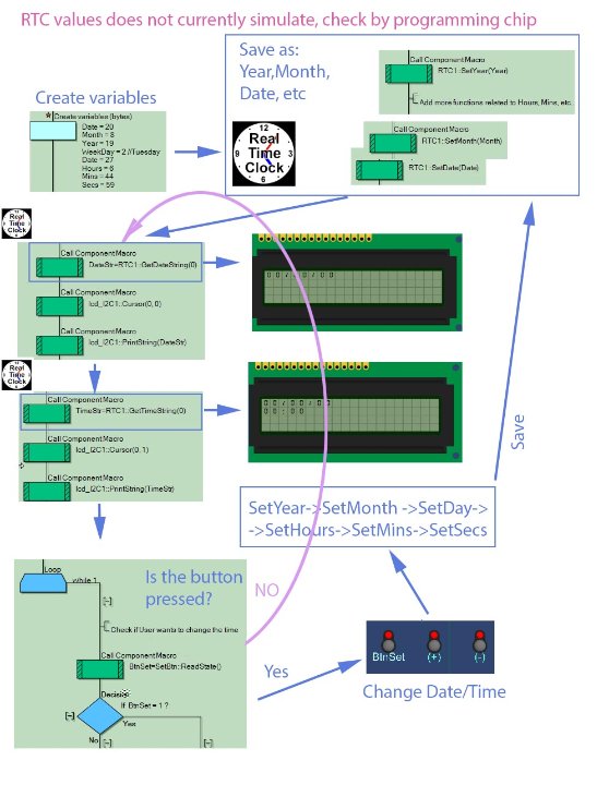

Re: Set Date-Month-Year with Real Time Clock
Understood Monie.
More questions to ask.
In you code - the button Reset (connected to E3) is basically a Set button.
This button waits for user response in two macros:
- in Main macro and
-in UR macro as well.
Why?
You set seconds in Main macro , compare the values of new and old seconds and print the result only if those values are not the same. Why do you compare the new and old seconds values and why only seconds?
Where do you get and print the Hours, Minutes, Seconds? I cannot find the code.
2. The UR macro is basically a Set time / date macro. But even if you set the time/date you cannot get out of this loop. No way to get out. Why?
Can you change your program Monie?
Can you:
1. Print on 1st row of LCD the string with DD:MM:YY (compile this code and see what happens)
Reads the current date from the RTC and returns it formatted as a string. e.g. DD:MM:YY
2. Add more code and Print on 2nd row of LCD the string with HH:MM:SS.
This function reads the current time from the RTC and returns it formatted as a string. e.g. HH:MM:SS. (Compile this code and see what happens)
3. Add more code later: use the buttons to change the values of DD:MM:YY and HH:MM:SS
With buttons the code is more complex, but it can be done by you. Just move slowly...
P.S. Please note: RTC Set -> does not currently simulate. That is the reason to do programming in steps. Do step 1 and check the results, do step2 and check the results, so on...
Information to read:
viewtopic.php?f=5&t=4005 - 24 hrs Clock
https://www.youtube.com/watch?v=fHByry0gefA - Digital Clock LCD 16x2 Using PIC16F1937 (Note: Youtube video (I think Flowcode v.5). You would be able to see how the code is organised in macros, the Set-Get sequence, etc.
https://www.instructables.com/id/24hr-T ... a-Circuit/ - Great tutorial about clock program creation in Matrix Flowcode environment.
John Crow (author or many Flowcode related articles) pubished this one:
Developing your own Flowcode 7 controlled weather station (with info about DS1307 RTC)
https://www.rs-online.com/designspark/d ... er-station
All the best.
