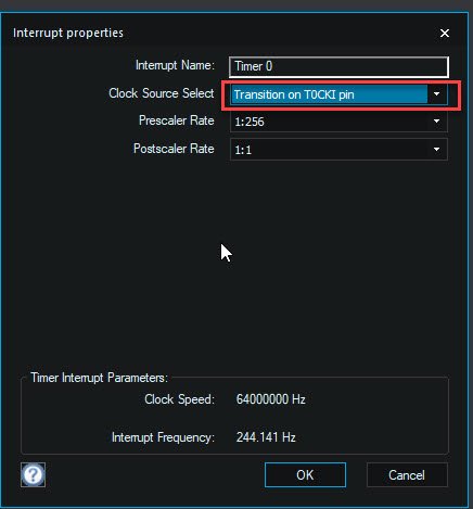

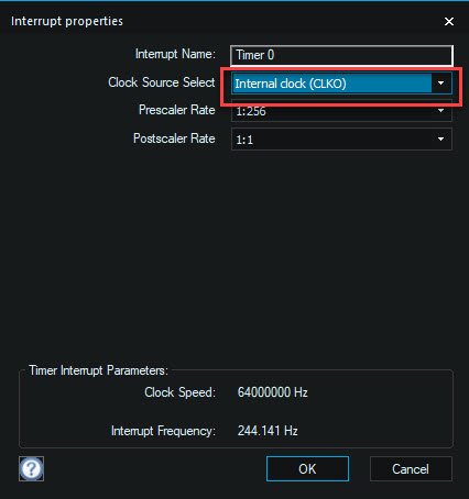

If you are not supplying a clock signal to the Timer 0 external clock Pin then the interrupt will never fire,in this case set the Timer clock to Internal Clock (Clock Source Property)
Set The property to Internal as shown below

Haha. Thanks, this was a silly one :shock:
