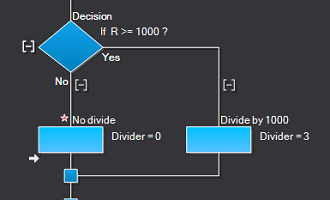

Hi all,
im having trouble with the decimal point, if the value is under 1000 ohms then all is well however when the value goes above 1000 i get the display showing for example 1013.Kohms (ohms denoted by the 4), if when the value is above 1000 how can i get the decimal point to show 1.013 k or even 1.01 k, im presuming its something to do with the floating point value but ive been unsuccessful in moving the decimal, any thoughts please
cheers bob
cheers bob

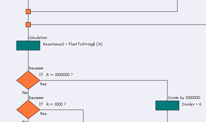

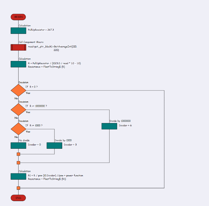

Hi Bob.
I have attached the way I would handle the dividing.
With the attached flowchart,
If R = 123.456 then the result on the display should be 123.4Ω
If R = 123456.789 then the result on the display should be 123.4KΩ
If R is 123456789.01 then the result on the display should be 123.4MΩ

Whoops, sorry.
The divider is to the power of
No divide is 10 to the power of 0 = 1.
I used 10 to the power 1 = 10
To fix that just change the 1 to 0:

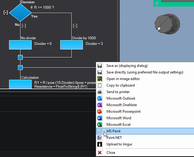

What I do is take a screenshot of the area I want, using a free program called Greenshot.
When you take a screenshot, after selecting the area you wish to capture, a popup appears asking how you want the screenshot saved. I save to paint.
I then use paint to save as png.
You could open your BMP in Pant and select File, save as PNG
If you don't want use Greenshot then if you press print screen, the capture will be saved to the clipboard.
You can open Paint, and paste (ctrl V) or use the paste clipboard icon.
Select the area you wish to use, then use crop.
Finally, save as PNG.
You can save as PNG within Flowcode.
Select File, Save Image.
Select either Flowchart, Dashboard, or system.
Select the dropdown that shows (*.BMP) then change it from (*BMP) to (*.PNG)

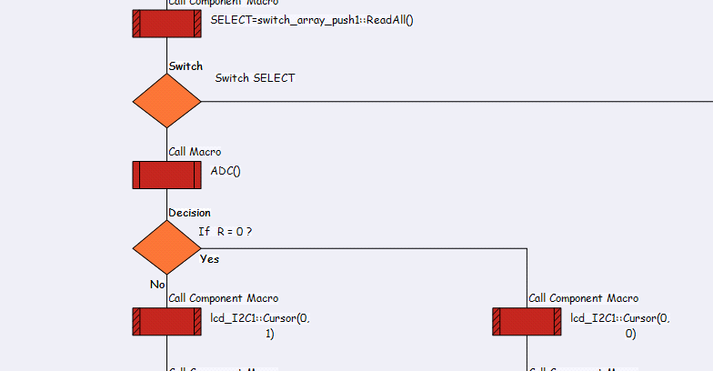

big thanks ive one more issue since changing the calc box to divider =0 when no resistance is connected i dont get the please connect come up on the display this did work before i made the change, i tried adding a decision box in the ADC macro with if R=0 this would then bypass the divider section but no joy
download/file.php?mode=view&id=33940
download/file.php?mode=view&id=33941
cheers bob
cheers bob

If the display does not show not connected, what does the display show as the value being?
When you get the reading, you can then change the in main to if R < (ValueShown + 0.1)
Perhaps the maths is making the value slightly larger, e.g. 0.0001, which then means R is not 0.
R = 0Perhaps the maths is making the value slightly larger, e.g. 0.0001, which then means R is not 0.

on start up with no value being measured the display shows 0.000MOhms
Bob

ive used a decision box in ADC macro above the divider calcs and put if R =0.000 so if no resistance it bypasses the diver blocks, ive then in the main put R=0.000 and it now seems to work, just seen your post so i will try your suggestion as well still need to try the Meg ohm function but will keep you posted and thanks for your input its much appreciated
cheers bob

a big thanks am i correct in thinking now that the ref resistor is 1.5Meg ?? as theres no reference to the original 267.3 ohm one, plus looking at the ADC macro has confused me a bit. as for local variables is it best practice to use these anyway or just when space is getting short, also there is a calculation box referencing Resistance 2 but this is not seen any where else ??
download/file.php?mode=view&id=33947
cheers bob
- kl.png (22.3 KiB) Viewed 27774 times
- Posts: 9521
- Has thanked: 2585 times
- Been thanked: 3815 times
Re: DECIMAL POINT HEADACHE
Hi Bob, the value of the reference resistor can be any value you like.
It's only 1.5M because that's what I believe is best for testing resistors in the M range.
The lower the resistance will be away from the reference resistor, in theory, the less accurate the results will be.
You can change it back to 267.3R of course, But you won't be able to measure anything above say 2K with any accuracy.
If it was me I would go no higher or lower than a factor of 7 of the reference resistor at a push.
The lower the factor the better.
1.5M is a factor of 1.5E6/267.3 = 5612!
It's best practice to use floats even if you have loads of space.
Resistance2 I used for testing.
It's no longer required so can be deleted.

a quick question, as you have stated the reference resistor at 1.5Meg im guessing i need to fit a 1.5 Meg to test this function also if i were to go back to the original 267.3 ohm resistor likewise again change the ref value from 1.5M to 267.3
regards bob

Hi Bob.
yes, you are spot on.
If you want to test resistors in the meg range, then the reference resistor needs to be in the meg range and the .ReferenceResistor has to be set for the same value.
I would suggest you need three ranges of ref resistances.
Mid 100's ohm
Mid 100k's ohm
and perhaps mid megohm?
Use the ADC value to auto-select the required range via either relays, reed switches or analogue switches
starting off with the lowest ref value.
Loop: If ADC >900 then switch in a higher value resistor: Exit loop
