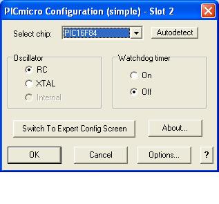

When I compile to chip, I get an error saying that the inboard chip is a 16F88 (correct) but the selected target is a 16F84 ( incorrect, I changed it above ). See attached ChipError#2.jpg.
I tried using PPP, and when I started it up it had 16F84 as the target. ( See attached ChipError#3.jpg). So I changed the target to 16F88 as required and downloaded the hex file to the chip. It went in fine and the program runs as expected.
I thought this may be the porblem, so tried downloading again from Flowcode, but still get the target selection error.
Any ideas?

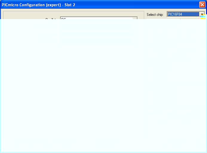

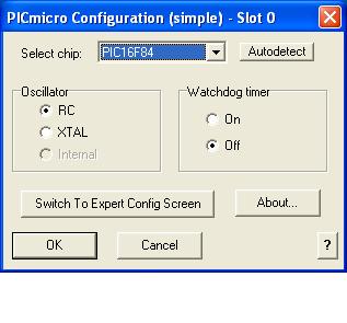

When I look in the 'Configure' screen for the target, I am happy that the Watchdog timer is off. See attached WatchdogError1.jpg.
When I look in the 'Expert Config Screen' I see that it says the Watchdog Timer is ON. See attached WatchdogError1.jpg. Which is correct.....??

Re: Changing Target
Hello
When changing your target chip in Flowcode simply remember to click the Chip -> Configuration menu to allow the configuration to be defined for the new chip.
The normal and experts screens may vary in settings, The settings that are actually assigned to the chip are the settings that are being displayed when you click the OK button.
Hope this helps.
Hope this helps.
