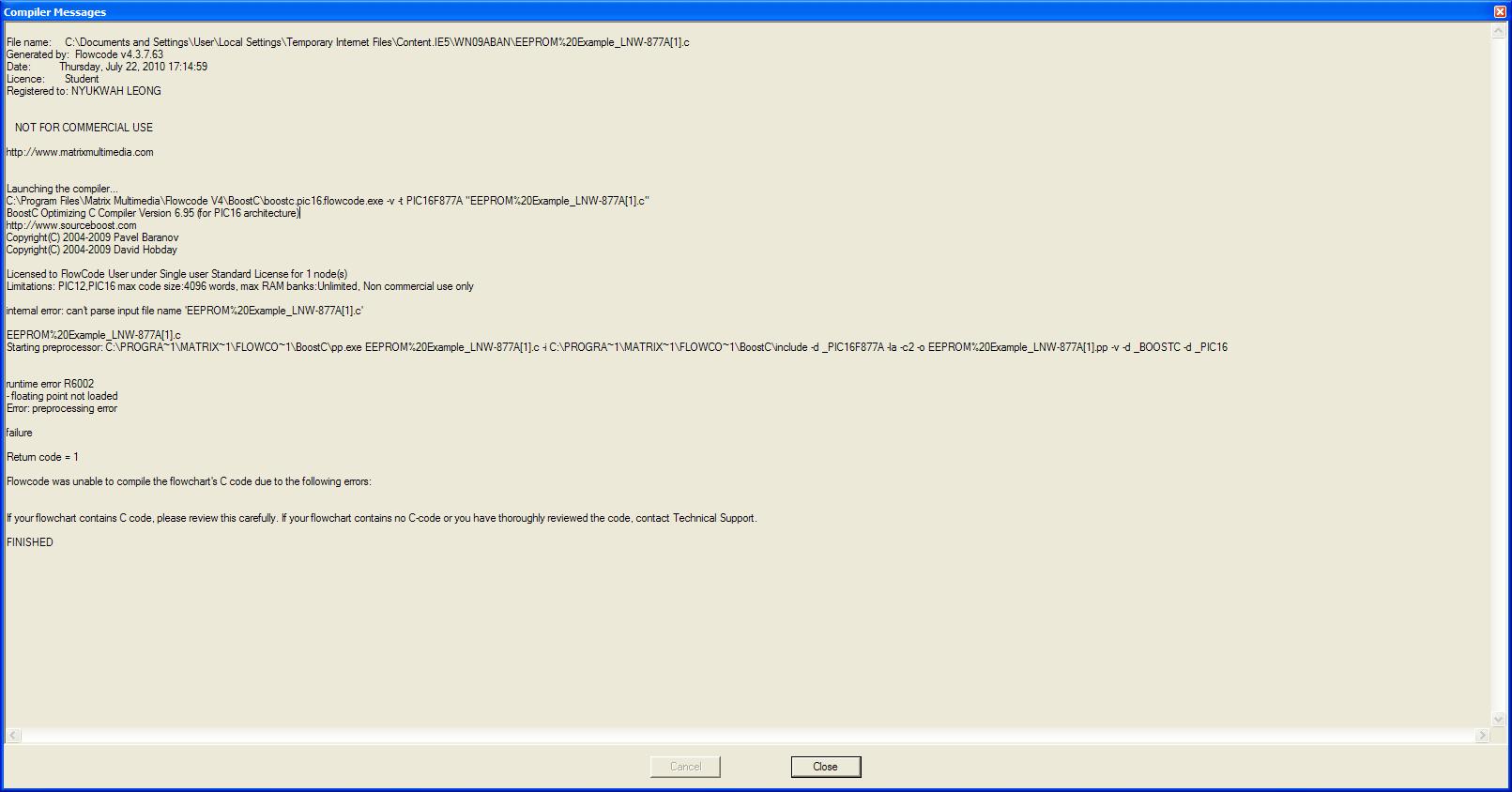

Thanks very much of your response. I did tried with your attachment download to PIC16F877A & 16F870 (I do not have PIC16F887), the programmer compiles with "floating point not loaded" error message and program fail. I had tried so many time but the error message persisted. I do not know what is wrong? My programmer E-006-6 is able to program other FC code without any problem.

Please find attached" programmer compile error message".
It seems that both of you are able to store the data into the EEPROM, I wander what is going wrong at my end. Is it possible the programmer itself has problom? I am using windows XP with service pack 3 , my PC is having a Intel dua core processor E7400 with 2 G ram. No anti-virus is installed.

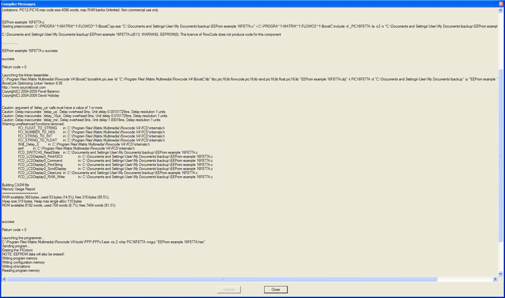

I manage to compile the fcf file if I cut & paste into a new file. The problem of unable to store the EEPROM date once downloaded to the PIC. I attached herewith the screen print of a sucessful download that I had noticed a WARNING EEPROM(0)statement stating" this licence is not generating flow code for this component." Is this statement has something to do with the EEPROM(0) data.
