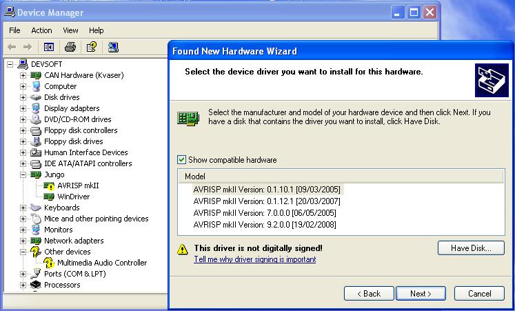

After uninstalling the Libusb driver and re-connecting the AVRISP programmer, the Found New Hardware proceddure should be used to manually select the driver:
Don't search the internet
Install from list or specific location
Don't search for the driver
This should display the available drivers:
In this case the two drivers with version numbers starting 0.1 are Libusb drivers and the other two are versions of the Jungo driver.
If this does not solve the problem, it maight be necessary to uninstall the current AVRISPmkII driver and re-install AVR Studio.
