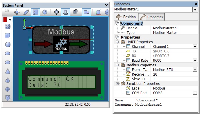

Example to talk to a CT-2EA Modbus Electronic kWh Meter FC6 Icon.png ModbusDemo Setup to communicate via Embedded UART1 or Simulated COM3

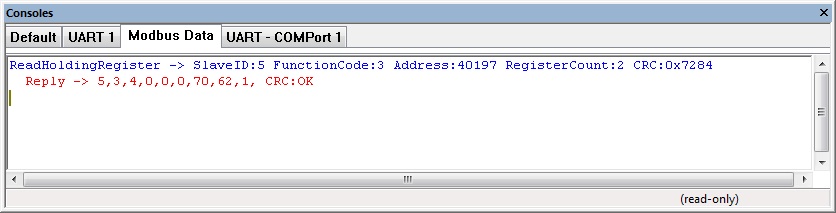

Console data generated by the working example
