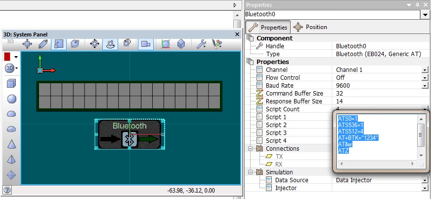

Example program to set up the Bluetooth module to be discoverable with a pair key. Any data received is then output onto the LCD component. You can connect to the Bluetooth device using a PC with Bluetooth connection and using software such as Flowcode 6, RealTerm or HyperTerminal. Alternatively you can connect using a smart phone running a terminal emulator app or via another embedded Bluetooth board. FC6 Icon.png Bluetooth Discover Script 1 contains the AT commands to setup the Bluetooth device to be discoverable with pair key "1234".

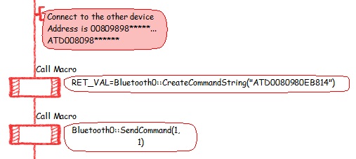

Connecting to a device
Example program to connect to a specific Bluetooth device address and send data to the device. FC6 Icon.png Bluetooth Connect The device MAC address is specified using the "CreateCommandString" and "SendCommand" macros.

Script 1
This property is of type Multiple lines of text and can be referenced with the variable name SCRIPT1.
Data to send for script 0, each command should be terminated with a carriage return
