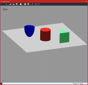

The System panel provides a real-world framework on which to load Flowcode components that compliments the [[Dashboard Panel]]. It is designed to show the physical representation of real world components during simulation.
Line 5: Line 6:
== Overview ==
== Overview ==
The System Panel is opened by selecting it in the View menu.
The System Panel is opened by selecting it in the View menu. Unlike the [[Dashboard Panel]], the System Panel is designed to simulate a 3D environment. It is best suited to designing and positioning objects as all aspects of an object can be viewed. Once an object is designed, it is often used in projects via the [[Dashboard Panel]].
When it opens, you see a central coloured square, called the ''Table top'', set against a coloured background. The colours or images of both are set in the [[Panel General Options|General Options]]. [[File:Gen_Panel_General_Options_01.png|border]]
When it opens, you see a central coloured square, called the ''Table top'', set against a coloured background. The colours or images of both are set in the 'General Options'. [[File:GeneralOptionsIcon.png|border]]
The System panel has a '''Shapes''' toolbar running vertically down the left-hand side, and a '''Controls''' toolbar running horizontally across the top.
The System panel has a '''Controls''' toolbar running horizontally across the top, much like the [[Dashboard Panel]].
[[Component|Components]] can be added to the System panel from the [[Tools and Views#3)Components Toolbar|Components Toolbar]]. Then, input devices like [[Component: ID 953a042a b2aa 4f2e 94e2 ee2979cfc92e|switches]] can be operated to control the progress of the simulation, while output devices, like [[Component: ID a7b05886 784c 48c8 a6f6 cc371c7728e1|LEDs]] show the result.

It is also useful as a surface for shadows, giving a sense of depth and orientation. The rotate mode of the camera treats the table top as the 'ground' and keeps the camera orientated with this in mind.

Multiple views
A powerful feature of Flowcode 6 is the ability to view the components from several camera angles simultaneously, enabling orthographic design of the system. Up to four views can be shown.
The number of views can be changed by clicking the 'General Options' Gen Panel General Options 01.png icon and then clicking on the drop down menu Btn Menu Arrow.png next to the 'Number of views:' option and then selecting a value from 1-4 on the menu.
By clicking on the appropriate arrowheads, you can set up each view as shown below.
Depending on the size and shape of the Systems Panel, the three views may be arranged vertically, instead of horizontally. Drag one edge of the Systems Panel sideways to see this effect.
You can adjust the viewpoint individually for each view, by operating the 'camera position' controls.
An example of doing so is given below - notice the positions of the red, green and blue arrows in each:
Alternatively, you can make changes to the objects themselves, in which case all three views are affected at once.
In the next image, the instrument panel has been rotated:
