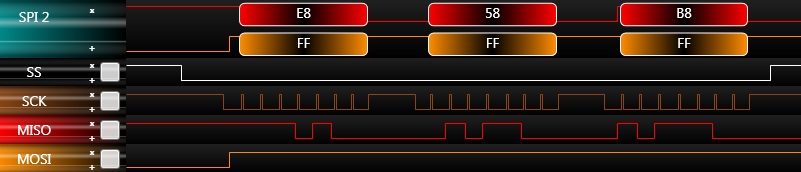

Each SPI transaction consists of a byte made up of 8 clock cycles allowing the 8-bits of the byte to be transferred.
