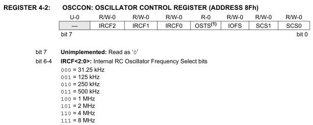

Here we have the datasheet for the PIC16F88 device listing the options available for the internal oscillator.

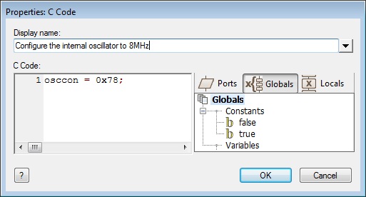

Here is an example to configure the internal oscillator to 8MHz on the PIC16F88.

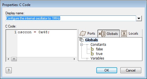

Here is an example to configure the internal oscillator to 1MHz on the PIC16F88.

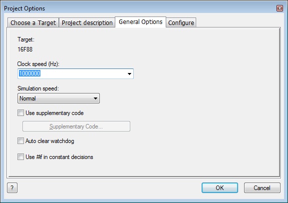

Be sure to set the clock speed in the project options to the same speed to allow your delays and any communications baud rates to be correct.

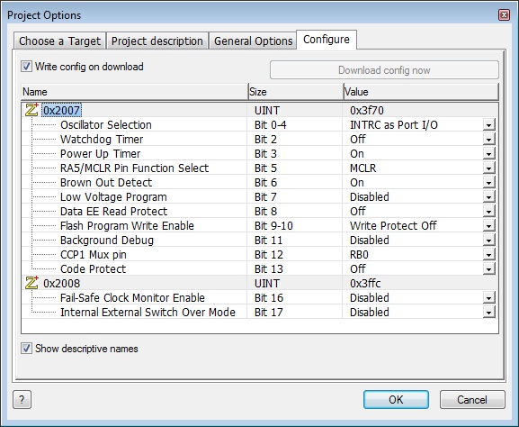

The configuration settings will also need to be edited from the default HS type oscillator to the IntOsc setting.
