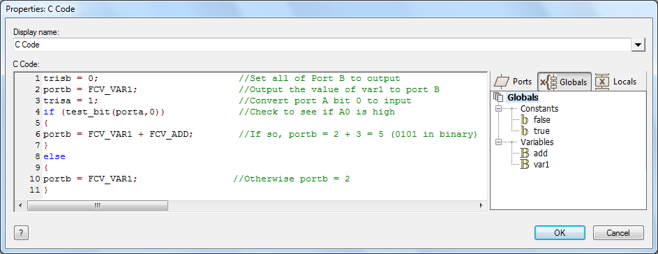

Configure the Code icon by typing in the following code, exactly as written here:
trisb = 0;                         //Set all of Port B to output
portb = FCV_VAR1;                  //Output the value of var1 to port B
trisa = 1;                         //Convert port A bit 0 to input
if (test_bit(porta,0))             //Check to see if A0 is highelse
The 'Code' icon properties box resembles that shown opposite.
The software recognizes instructions and comments, and colour-codes them accordingly.
Some notes on this code:
