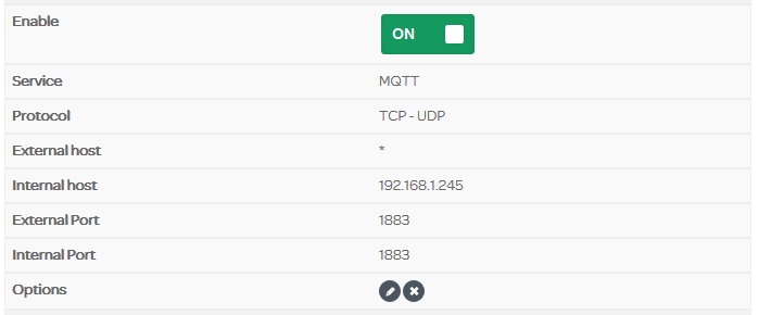

So far we have been communicating with the broker on a local area network. To make the broker available to the internet we have to expose the MQTT port to the internet. The easiest way to do this is to configure your router to port forward the MQTT communications port (Default 1833) to your local IP address.
Here my broker has an IP address of 192.168.1.245 and I have configured forwarding for port 1833 by logging into my internet router.
Guides for various models of routers are available from here.
https://portforward.com/router.htm
To connect to the broker from your local network you would use the local IP address as normal, for me that's 192.168.1.240.

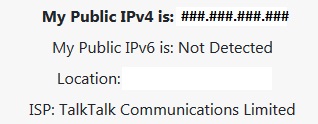

To connect to the broker from the internet, external to your local network then you would use your routers IP address. To find this you can simply visit whatismyip.com from within your local network.
