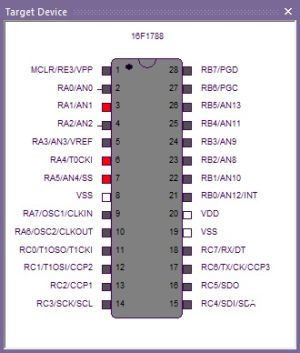

3) Chip View
The current microcontroller is displayed in this window. When the flowchart is being simulated, the state of the microcontroller I/O ports are shown on the microcontroller as red and grey for high and low outputs respectively.

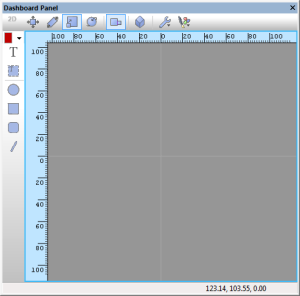

Dashboard Panel
6) Dashboard Panel
The Dashboard Panel provides another framework on which to load Flowcode components. It is usually used for buttons to control components on the System Panel. It can also be customised by adding different background layouts, grids, images etc.

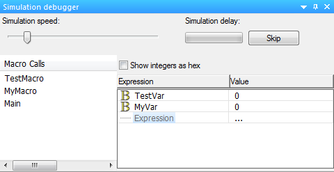

9) Simulation Debugger
This window appears when simulating a flowchart, it shows the current macro being simulated as well as the values of any variables selected, the values of the variables are updated for every command simulated but does not update when running the simulation 'As fast as possible'.
When simulating a flowchart, the values of any variables used can be seen in this view. The values of the variables are updated for every command simulated but the view is not updated when the simulation is running at full speed.
