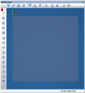

- 3D System Panel - The System Panel provides a 3D (real-world) framework on which to load Flowcode components to provide a 3D simulation. It can be used for most components however will not work with the new 2D only GUI simulation components.

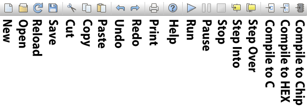

Use this command to display and hide the Toolbar, which includes buttons for some of the most common commands in Flowcode, such as 'Open' (File > Open), 'Print' (File > Print) as well as Compiling the flowchart to Chip, HEX and C. You can even control simulation by running, pausing and stopping simulation using this toolbar as stepping into and over icons to simulate step by step.
