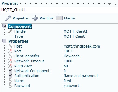

Using a Username and Password in Flowcode
To add the username and password into Flowcode you simply have to edit the MQTT component properties to switch on authentication and set the details.
