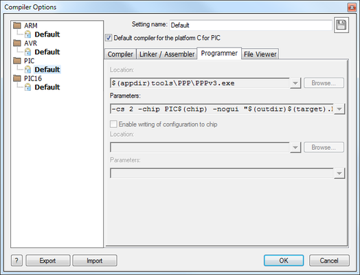

[[File:Gen_Compiler_Options_Programmer_PIC.png|right|524x400px]]
[[File:Gen_Compiler_Options_Compiler_PIC.png|right|524x400px]]
Each version of Flowcode comes ready with a default programming tool. However it is fairly easy to change the settings in Flowcode to allow for third party programming tools to be used.

For help with third party programming tools the first port of call should be to check our [http://www.matrixmultimedia.com/mmforums/ forums] to see if anyone else has already tried the programming tool with Flowcode. If you are the first then if you wish you can post your findings for other users to benefit from.
==Warning==
Editing the Compiler or Linker tabs of the compiler options will likely stop Flowcode from being able to compile correctly unless you know what you are doing.
The settings below are for the '''Programmer''' tab of the compiler options. <span style="color:#FF0000">Take care to ensure you '''only''' edit the values in the '''Programmer''' tab.</span>
If you do edit the values in the compiler or linker tab then you can simply revert back to the default settings and start again.
The programming tool that is invoked when the compile to chip button is pressed is configured in the Build menu under Compiler options then click on the Programmer tab page.
For help with third party programming tools the first port of call should be to check our forums to see if anyone else has already tried the programming tool with Flowcode. If you are the first then if you wish you can post your findings for other users to benefit from.
Warning
The settings below are for the Programmer tab of the compiler options. Take care to ensure you only edit the values in the Programmer tab.

Parameters:
-cs 2 -chip PIC$(chip:u) -nogui "$(outdir)$(target).hex"
PICkit2
Location:
$(appdir)tools\PICkit2\pk2cmd.exe
Parameters:
-B$(appdir)tools\PICkit2\ -PPIC$(chip) -F$(target).hex -M -A5 -R
