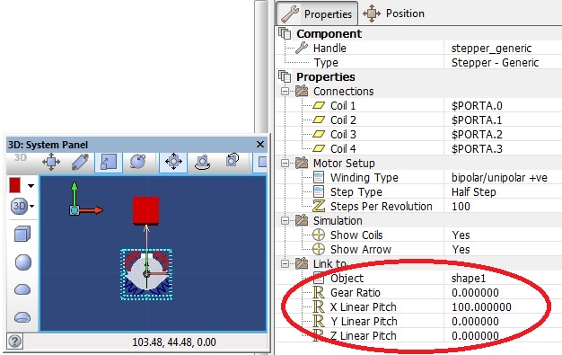

Attaching a primitive to a stepper motor
This example links a panel primitive to the output of the motor. FC6 Icon.png Stepper Example 1 The linked object can be rotated or moved in a fixed direction by the motor.

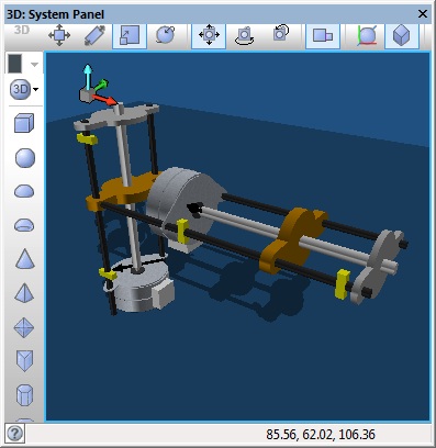

Linear movement using a stepper motor
This example links two stepper motors together using linear type movements rather then rotational similar to a stepper attached to a lead screw. FC6 Icon.png Stepper Example 2 The stepper is linked to the objects on the panel using properties and grouping.

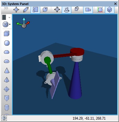

Creating a multi-axis actuator using stepper motors
This example links three stepper motors together using panel primitive objects and groups. FC6 Icon.png Stepper Example 3 Here we can see the actuator arm in motion.

Gear Ratio
This property is of type Floating point and can be referenced with the variable name gear_ratio.
Set a non-zero value here to make the target object rotate whenever the motor spins. The target
will revolve around the same axis as the motor's own 'Moving Part' (e.g. drive shaft).
A value of 1.00 make the target spin at the same speed as the motor. Choose other values
to set the ratio of a 'virtual gearbox' to change the speed of the target's movement.
X Linear Pitch
This property is of type Floating point and can be referenced with the variable name x_pitch.
Set this to a non-zero value to move the target object linearly along its X-Axis whenever the motor spins.
The value is the distance to move (world units) per complete rotation of the motor shaft - i.e. it
simulates a typical linear drive that uses a lead-screw, with the property value equal to the
screw pitch.
Y Linear Pitch
This property is of type Floating point and can be referenced with the variable name y_pitch.
Set this to a non-zero value to move the target object linearly along its Y-Axis whenever the motor spins.
screw pitch.
Z Linear Pitch
This property is of type Floating point and can be referenced with the variable name z_pitch.
Set this to a non-zero value to move the target object linearly along its Z-Axis whenever the motor spins.
screw pitch.
