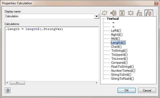

String Functions
The String functions are a set of string manipulation functions that can be used to edit, change and examine the strings.
To add a function, drag it into the calculation box or double click. The user can then edit this base code with the variables required.
Btn Calculation.gif Gen Calculation Flowchart Icon 01.png Gen StringFunctions 01.jpg
