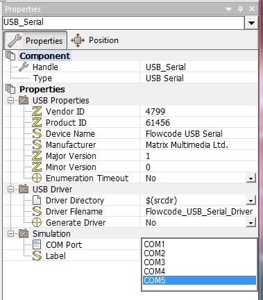

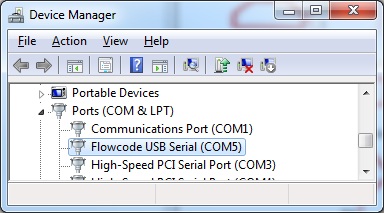

Here is an example file which is designed to run in simulation to communicate with the connected embedded device. The COM port property will have to match the COM port for the embedded device to allow the communications to work correctly. Alternatively a program like Hyperterminal or RealTerm can be used to generate the COM port data to send to the connected device. FC6 Icon.png USB Serial Simulation Finding which COM port has been allocated to your embedded device is as easy as opening the Windows device manager and looking under Ports.
Assigning the correct COM port in the simulation needs to be done to allow the communications to work correctly.

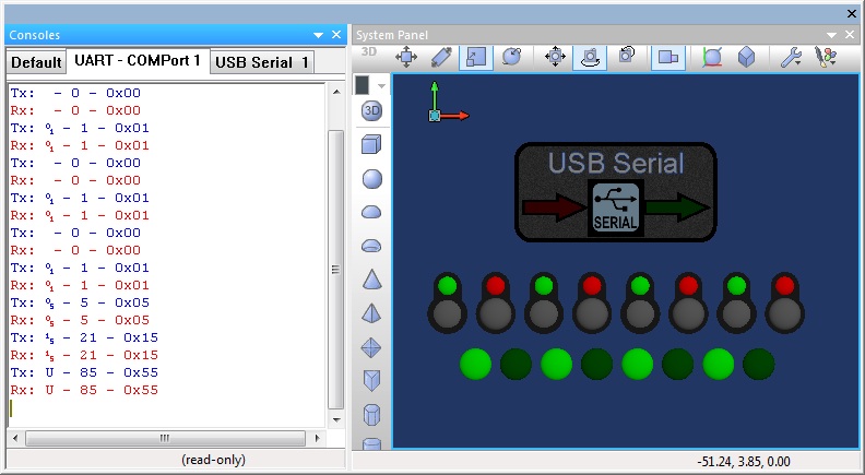

Example of the data console with data being passed back and forth between the simulation and the embedded device.

Property reference
Fc9-prop-icon.png Properties
Fc9-conn-icon.png USB Properties
Fc9-type-21-icon.png Vendor ID
USB VID
Fc9-type-21-icon.png Product ID
USB PID
Fc9-type-10-icon.png Device Name
USB Device Name
Fc9-type-10-icon.png Manufacturer
USB Manufacturer
Fc9-type-14-icon.png Major Version
USB Major Version Number
Fc9-type-14-icon.png Minor Version
USB Minor Version Number
Fc9-type-16-icon.png Return Type
Specifies the way the receive function indicates a timeout. 8 Bit mode - Timeout is represented by the value 255. 16 Bit mode - Timeout is represented by the value 512 allowing the value 255 to represent valid data
Fc9-type-7-icon.png Enumeration Timeout
Specifies if the enumeration (Initialise function) can timeout if taking too long.
Fc9-conn-icon.png RAM Usage
Fc9-type-21-icon.png Transmit Buffer Size
Sets the size of the transmit buffer. Recommended to be between 8 and 64 bytes.
Fc9-type-21-icon.png Receive Buffer Size
Sets the size of the receive buffer. Recommended to be between 8 and 64 bytes.
Fc9-conn-icon.png USB Driver
Fc9-type-20-icon.png Driver Directory
Directory to save the generated device driver .inf file
Fc9-type-10-icon.png Driver Filename
Filename to give to the generated driver file.
Fc9-type-7-icon.png Generate Driver
Generates a driver file when set to Yes, Automatically jumps back to No when complete.
Fc9-conn-icon.png Simulation
Fc9-type-12-icon.png COM Port
Hardware COM port to communicate with any connected USB serial devices or any other virtual COM ports.
