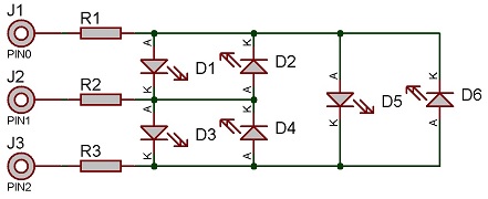

If all the LEDs you want to drive have the same characteristics then you can wire up like this to use the same current limiting resistors to drive multiple LEDs.

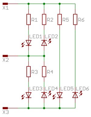

If the LEDs you want to drive have different characteristics then you can wire up like this to use different current limiting resistors for each individual LED.

The value of resistor used can be changed based on the brightness of the LED and power consumption.

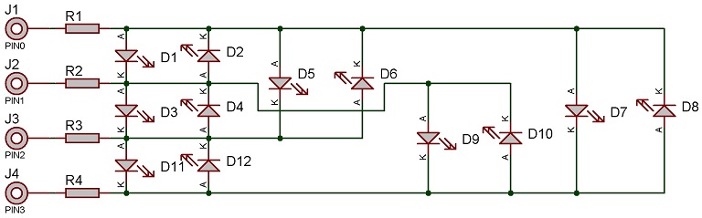

Here is an example of a 4-pin setup.
