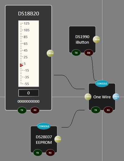

Example One Wire comms component being referenced by several specific One Wire device library components.
