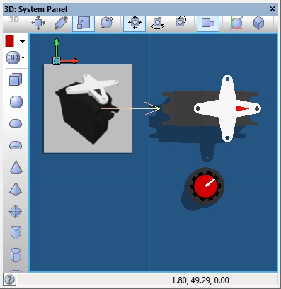

Controlling a servo with an analogue input
This example reads the value of the analogue potentiometer and uses this to set the position of the servo motor. FC6 Icon.png Servo Example 1 The Servo controller is linked to the standard servo component but this could be linked to any object on the panel.

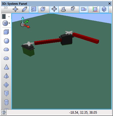

Creating a multi-axis actuator using servo motors
This example links two servo motors together using panel primitive objects and groups. FC6 Icon.png Servo Example 2 The Servo controller can handle up to 8 motors and is used to control both of the standard servo components on the panel.
