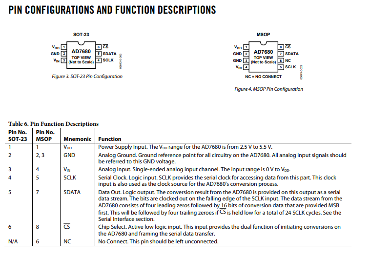

The AD7680 is a 2.5V to 5.5V SPI compatible, successive approximation analogue to digital converter (ADC).
The reference for the AD7680 is taken internally from VDD
Pin reference from the datasheet:

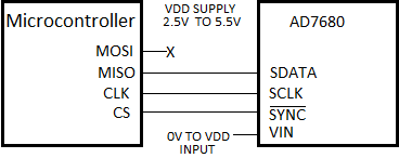

This example reads the voltage on the AD7680 Vin and converts the ADC results into a voltage. For the result to be correct, you must change the Voltage variable to match the supply voltage.
Circuit Diagram
