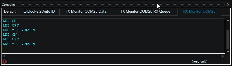

Here is a simple example showing how to pass data from a device such as an Arduino back into Flowcode for debugging purposes. The example is designed to run on an Arduino Uno R3 with an LED connected to pin D2 and a potentiometer connected to pin A0. The program loops switching the LED on and off and reporting the status to the console, the ADC is also sampled as a voltage string and this is also passed back to the console.
FC6 Icon.png Serial Monitor Demo
The incoming data can be seen on the Flowcode console even when the simulation is not running.

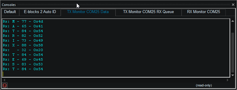

Outgoing data can be sent back to the embedded hardware by typing data directly into the RX Queue tab of the console.
