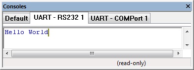

Transmit
This example transmits a string "Hello World". FC6 Icon.png RS232_Example1 The Console window shows the data as it is sent and received.

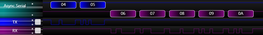

Receive
This example receives a character and outputs it to the LCD, an injector has been added to allow you to type data into the console. FC6 Icon.png RS232_Example2 The Console window has tabs for the human interface data injector allowing you to type in data that will be received by the component.
Again the RS232 console tabs reflect the data as it is sent and received.
