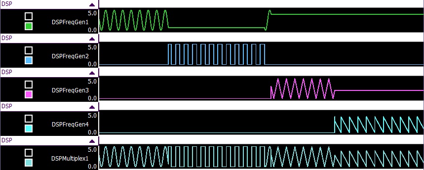

Multi Wave Signal Generator
Switch-able mode frequency generator example file generating different waveforms depending on the value on pins RB0 and RB1.
0 = Sine, 1 = Square, 2 = Triangle, 3 = SawTooth
FC6 Icon.png FreqGenMulti
The frequency is controlled by adjusting the potentiometer on the panel, the waveform is controlled by adjusting the switches on the panel.
