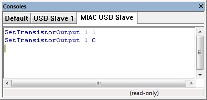

Here is a simple Flowcode program to toggle one of the transistor outputs on the MIAC USB Slave device. Remember to connect a linking wire between the (M) screw terminal to the (V+) screw terminal to allow the Transistor LEDs to light. FC6 Icon.png MIAC USB Slave Here is an example of the high level MIAC USB Slave console.

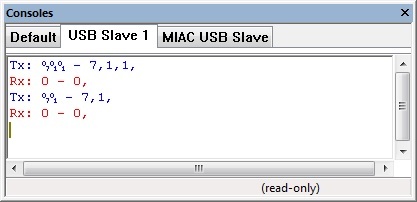

Here is an example of the low level MIAC USB Slave console.

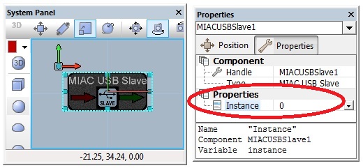

If the MIAC USB Slave component can see the MIAC USB Slave then you will able to select the instance via the Instance property.
Multiple MIAC USB slaves can be connected to a single PC and controlled by adding multiple MIAC USB Slave components each referring to their own instance of the hardware.
