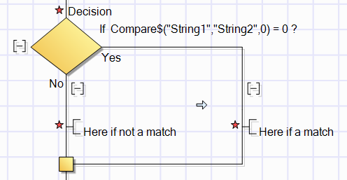

Just in case you want to compare two string values:
Compare Strings1.png (22.61 KiB) Viewed 7823 times
Which is:
Compare$("String1","String2",0) = 0
You can either use literal string values within quotes e.g. "1234ABC" or string variables or a combination of both.
See this Wiki page.

Hi Martin
Thank`s
Exactly what I was looking for, and have seen :D
So I can transmit a string and receive this string, then compare the string, if the received string is equal with the string in the compare, Then do something, set an output, I suppose ;)
But please what does String2",0) = 0 mean, the ,0)=0 if correct string? Edit. Just seen it on wiki :lol:
