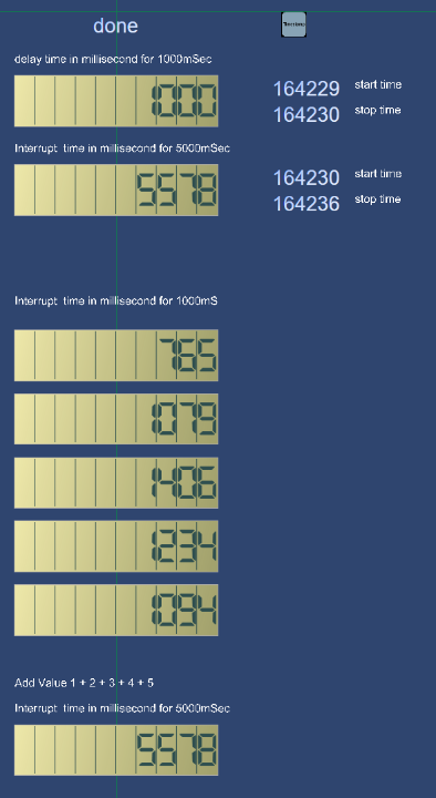

I wrote a small App to check delay time and Interrupt time.
The delay is really nice. For 1 Sec I get 1000mSec. Not so good is the Interrupt. I get a lot of different times so I checked 5 times the value.
Each value should be 1000mSec and all together 5000mSec.
FC9_simple delay_test_milisec_2.fcsx
(44.04 KiB) Downloaded 720 times

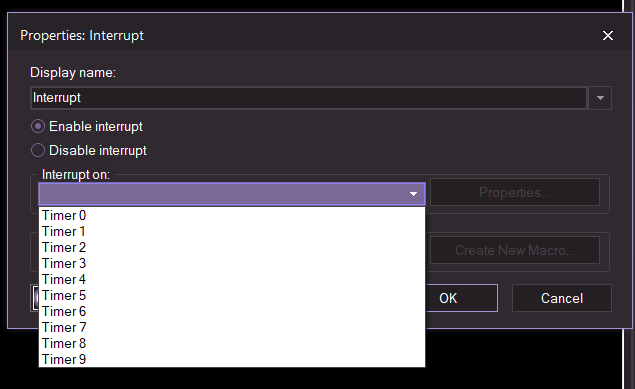

I suspect there is no other way to trigger an interrupt in the App Developer
At the moment I can work with the timer interrupt with a tolerance of + -20%. Thank you that this little problem is on the to do list

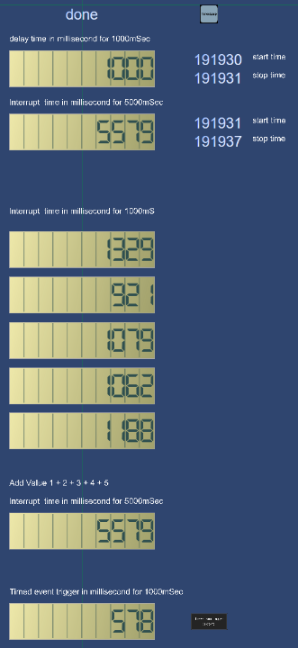

Hi Martin
I like your idea.
So I included the time event trigger in my test. But that acts the same as an interrupt!
Varible result and instead of 1000 milliseconds sometimes only 578 milliseconds
I am not sure if I did all this test correct. But it cannot be compared with a Swiss watch :)
(51.06 KiB) Downloaded 596 times

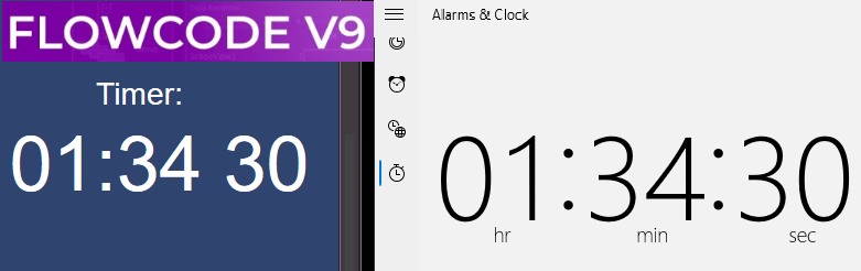

Hi Stefan,
Try the attached.
The time will count every second from -5
Use a stopwatch and start it as soon as seconds reach 0.
Leave for a period of time, e.g half an hour.
Then compare stop watch with the time elapsed on the display.
Re: App Developer Perfect delay, but not stable Interrupt
Posted: Wed Apr 07, 2021 10:08 am
by stefan.erni
Hi Martin
With your program everything works fine, I let it run about 94 minuten (still running) and less than 1 second difference
So I will check whats wrong on my stuff.
regards and thank you
