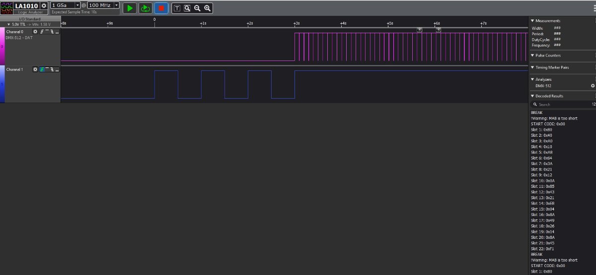

I replaced Martin's "initialisation" with the FC component.
I then got a trace on C7 (hardware pin).
Screenshot 2025-06-07 104733.jpg (54.67 KiB) Viewed 2098 times
However I notice in the decoded results that there is a warning that the MAB is too short (Mark After Break). I would need to read up on DMX protocol but this could possibly be accounting for the errors, as perhaps it is knocking timings out?

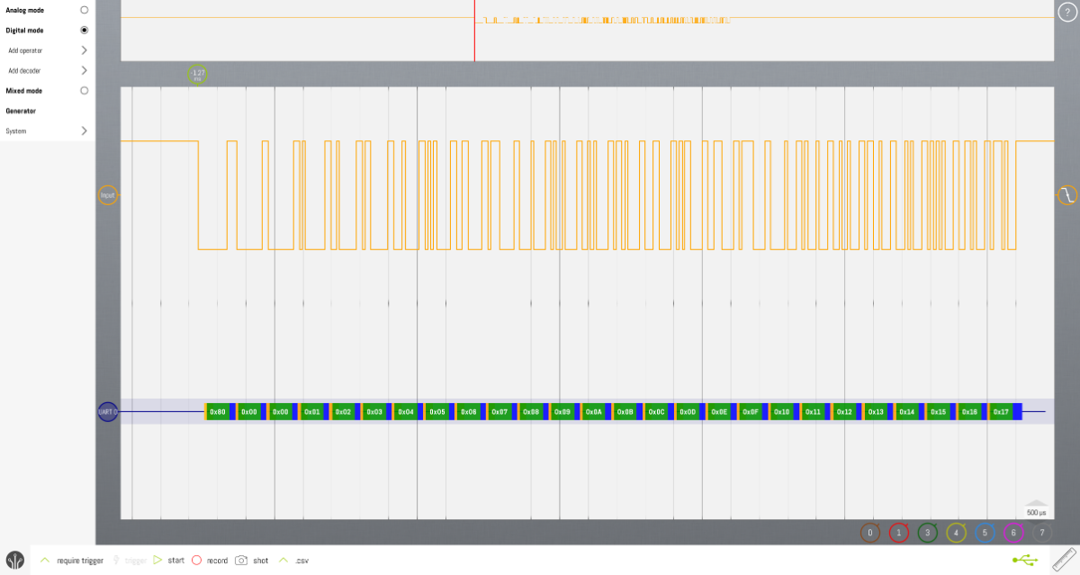

Whilst waiting for a 16F18877 to arrive in the post - I tried a different MCU.
So with a PIC16F887 (which is rather a lower specced beast) - I got a simple DMX output running (I think)
Here outputting 24 channels (set to 0..23) My logic analyser reads the 'start' pulse as 0.
I'm using '0' as the control byte too (this could be set as data[0] or passed as a parameter depending on requirements but at present SendDMXPacket has it hardcoded as 0.
This is with the MCU running at 8MHz

Further to above, I haven't looked at the component but would it be possible to increase the MAB from the current 2.06uS ?
From the web it suggests it should be 8uS but who knows how accurate that source is?

I could download it to a 18877 without issue, but when run my decoder informs that the MAB is to short (being 2.06uS).
This may be a typo in the component. Perhaps Matrix could check?
