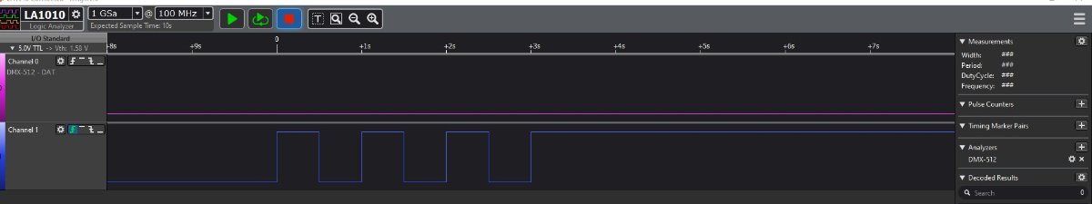

I downloaded Martin's chart, added in OSC settings as per "helper" and included a flash test for sanity. This pulses pin C2 three times, goes low then after the DMX is initialised goes high.
This is just to see if anything is happening.
On the below trace Ch0 is the DMX pin (C0) with Ch1 on C2 monitoring pulses.
As you can see the pulses are captured but the DMX pin remains flat. No output.
