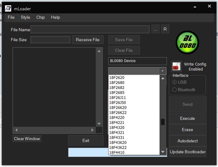

Based on the target list I don't think you can program the 18F27K42 directly in the BL0080 using mLoader (but you could via the ICSP).
Screenshot 2025-03-30 102933.jpg (50.5 KiB) Viewed 4749 times
Maybe someone in Matrix can confirm?

By the way one more doubt, kindly excuse if i sound stupid, what i understand is the i cannot download the program in the said chip directly using "Compile to Target" button, but i can using ICSP instead, but my main concern is debugging, does that mean i cannot use the ghost function too for the said chip ie 18F27K42.

Yes as ChipFrier has pointed out I'm afraid the BL0080 will not directly support reprogramming the 18F27K42 device but can be programmed on the board via the ICSP socket and a programming tool such as the PICkit3.
As far as Ghost is concerned the ICT should work straight away. The ICD should also be fairly easy to get going but may require changes to the chip definition file (FCD).
